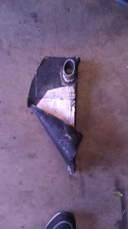

You can see some other effects of the fire... the melted Alarm siren...
And what it looks like from underneath at the fenderwell....

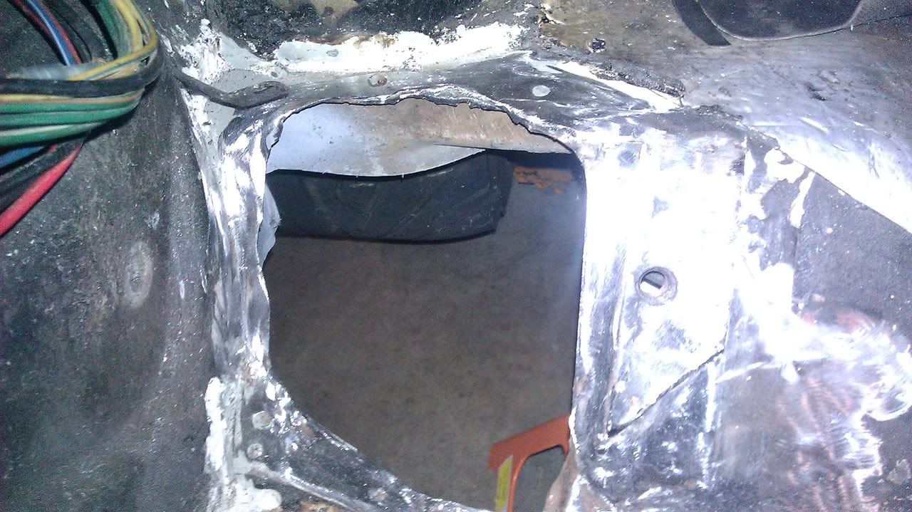

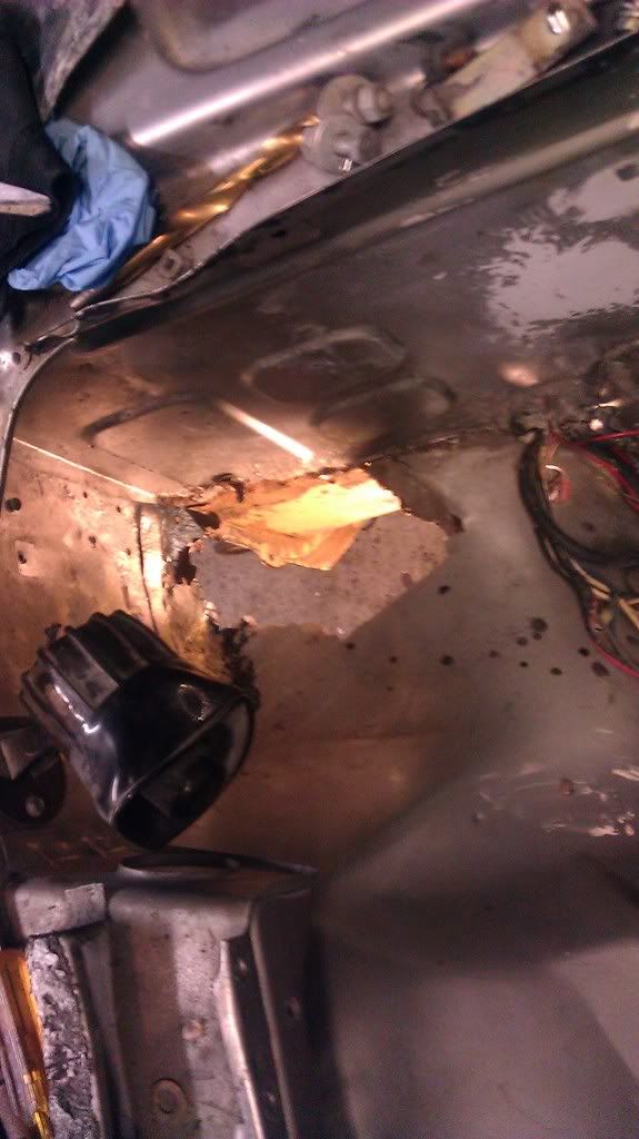

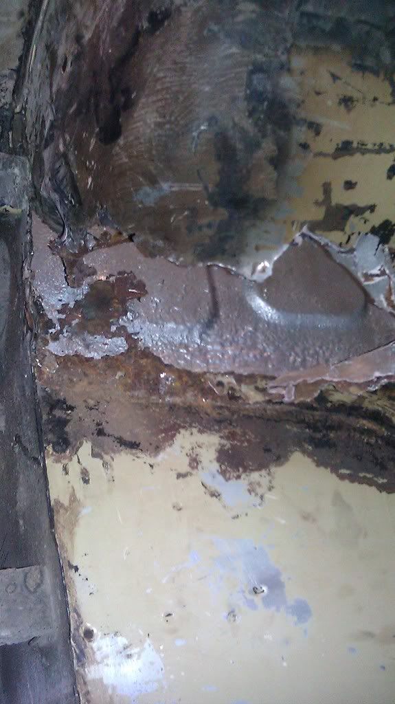

So that is what remains of my battery box area..... Most of the "metal" that is missing was simply pulled away with pliers. What sucks is that the rust attacked the firewall enough that I am going to have to replace a section of firewall too... yay.. have to rip out the interior now... Not all bad...
Now I can fill in the hole where the wiring came through the firewall and send all of the wiring directly into the fenderwell and move the fusebox inside the car. I think I might try and get a hold of a LS1 wiring harness and computer to see how I want to mount and run those wires as well.

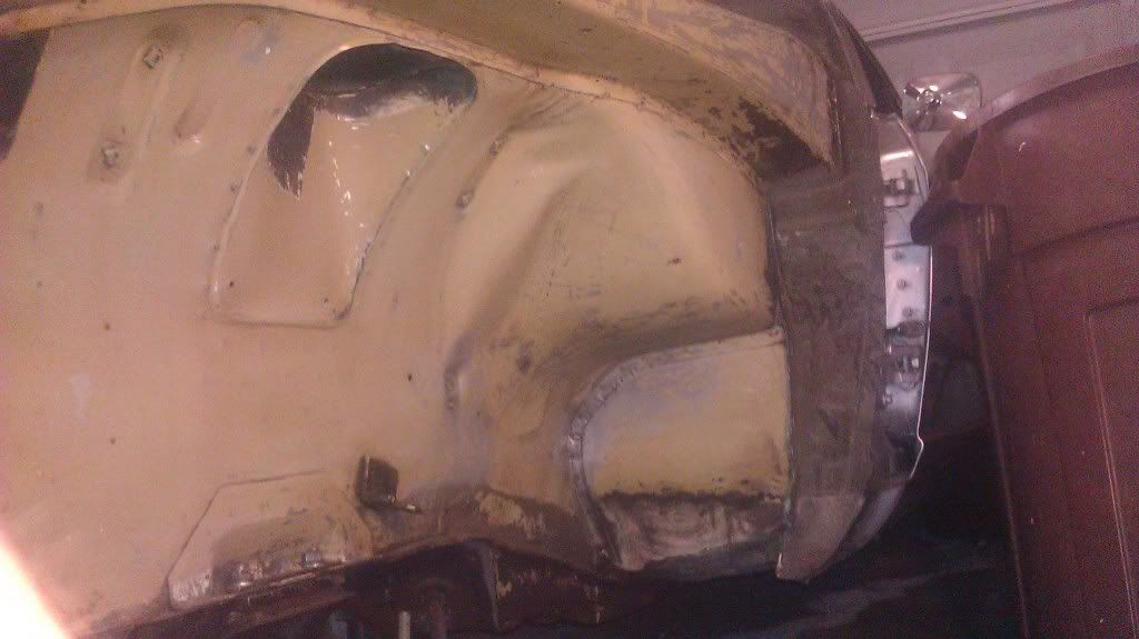

Pulled out the strut on the driver's side and scraped away almost the last of the undercoating.
Edited by 280zcar
Lol absolutely. It's just so hard not to address the things I've been putting off for some time. At least I'm leaving the front suspension and brakes alone... Probably... Maybe.... Ahhhhh... There is no escaping the infamous "while you're at its."

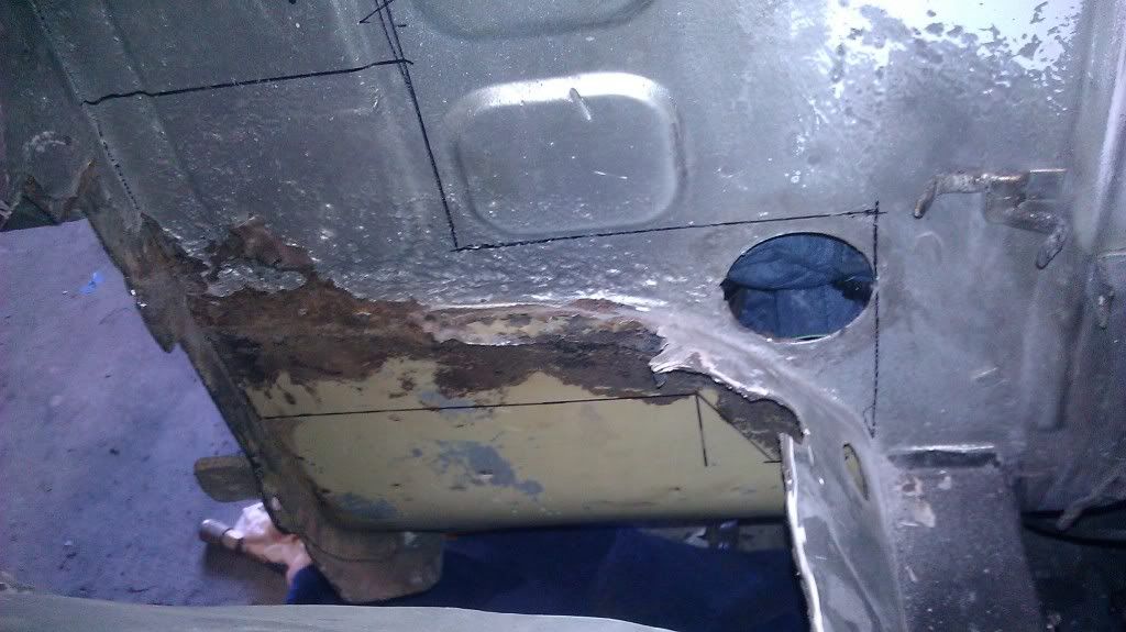

Cut out most of the fenderwell area that will be replaced. I also started to draw out the section of firewall that will be removed. I need to get the dash out and see exactly where I want to cut to avoid as many brackets as possible.
also pulled the passenger strut and finished the last of the undercoating scraping...
for anyone curious I removed all of the undercoating with some paint stripper, a 1.5 inch blade scraper, and a bunch of mineral oil with a scotch brite pad.

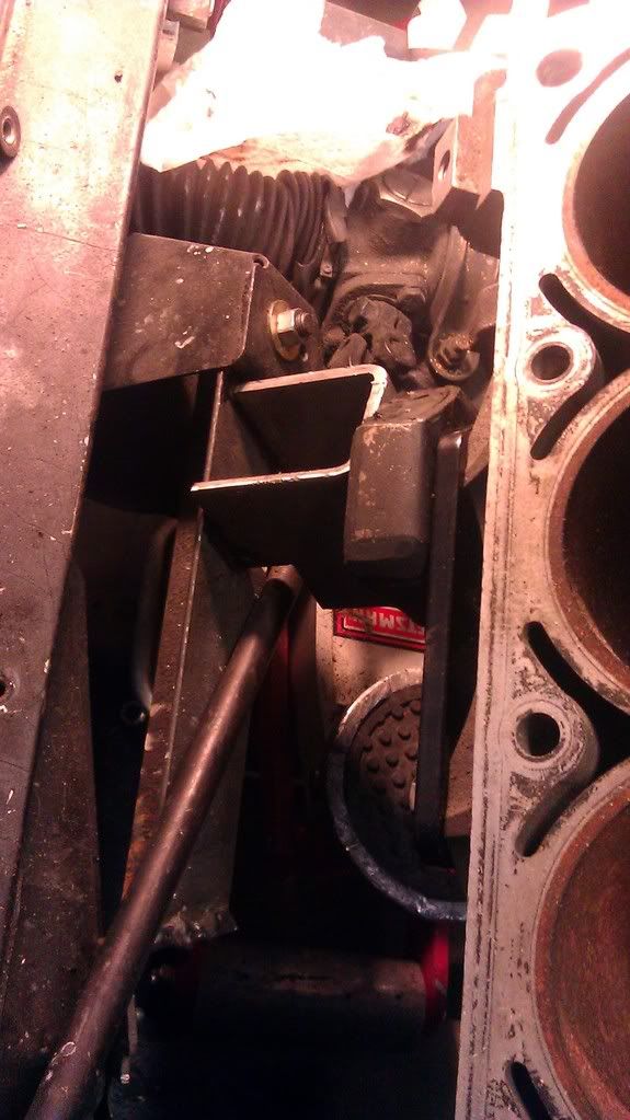

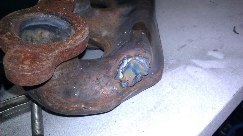

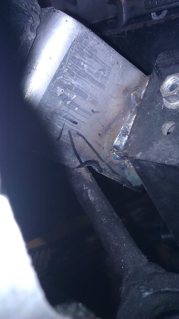

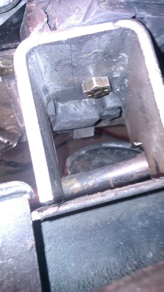

Drivers mount welded up.
I need to trim the corner that is hanging off.
Passenger side: first attachment point reinforced.
Triangular shaped piece is a piece of angle iron and will be bolted to the crossmember as a second attachment point.

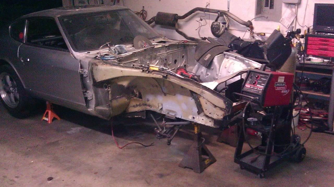

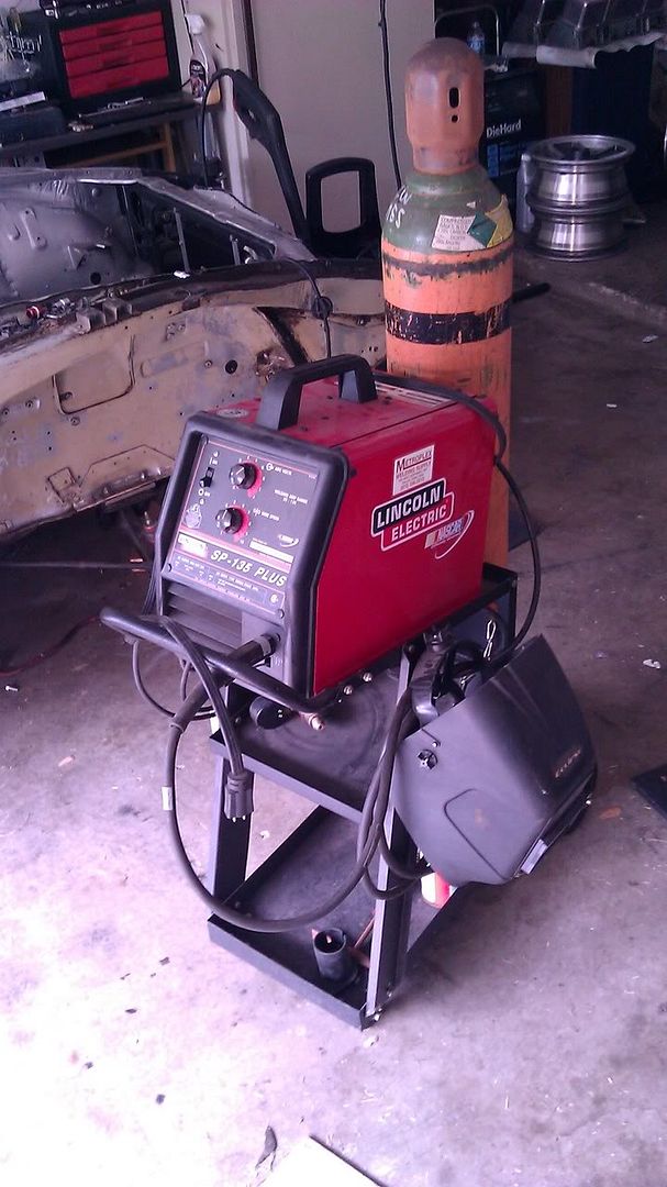

Picked up a mig welder.
I've been using a friends welder for the mounts and such. I figured it was about time to pick one up for myself and stop mooching off him. I still need to get some wire and exchange for a new gas cylinder.
It's nothing fancy but it should be adequate for some light sheetmetal duty. I'm sure I'll upgrade at some point but it should do the trick for now.
It's a Lincoln sp-135plus 115v.
I was glad to find a 'plus" model because the voltage setting is variable and not tapped for only ~4 settings. Guy who i bought it from only used it to build a fence ~5 years ago and its pretty much been sitting dormant in his garage since then.
Plan is to weld in new sheetmetal at the battery tray and then probably end up filling some of the holes in the engine bay/minor seam welding.

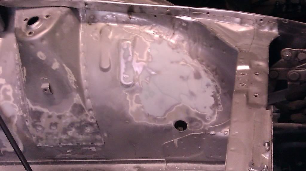

Started welding up the holes in the engine bay and grinding them down...
Edited by 280zcar

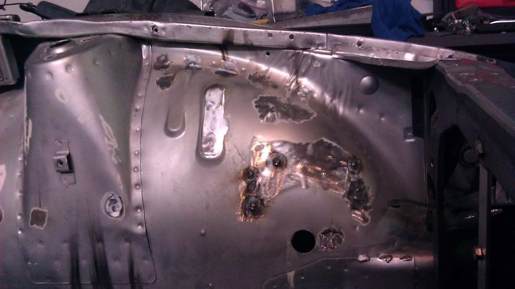

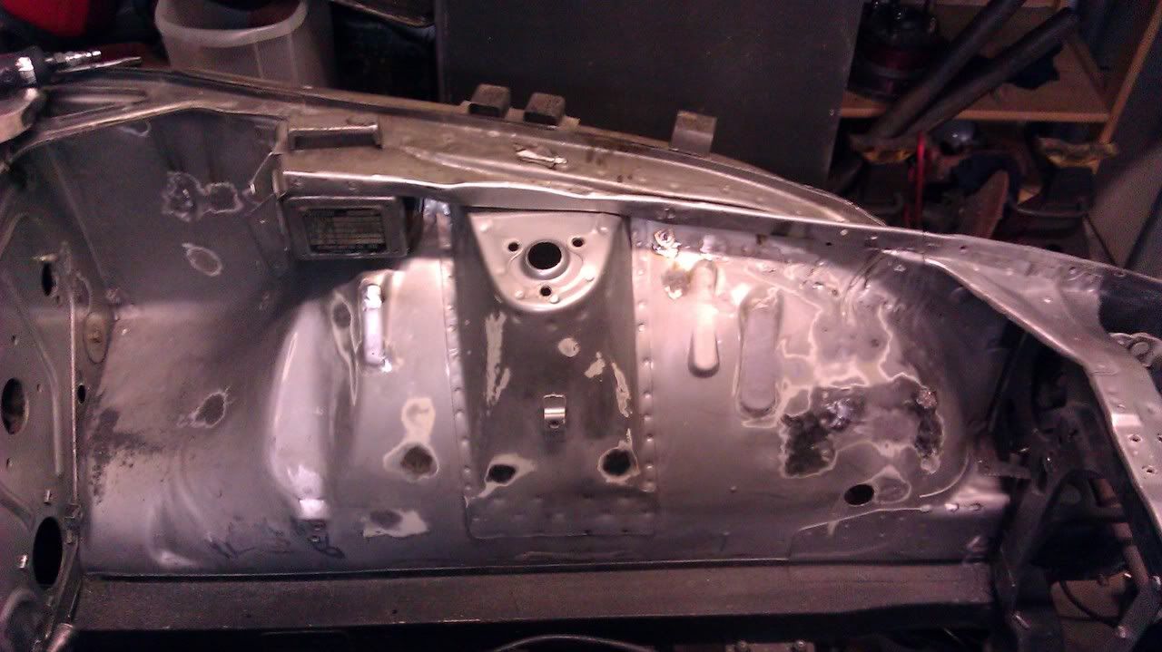

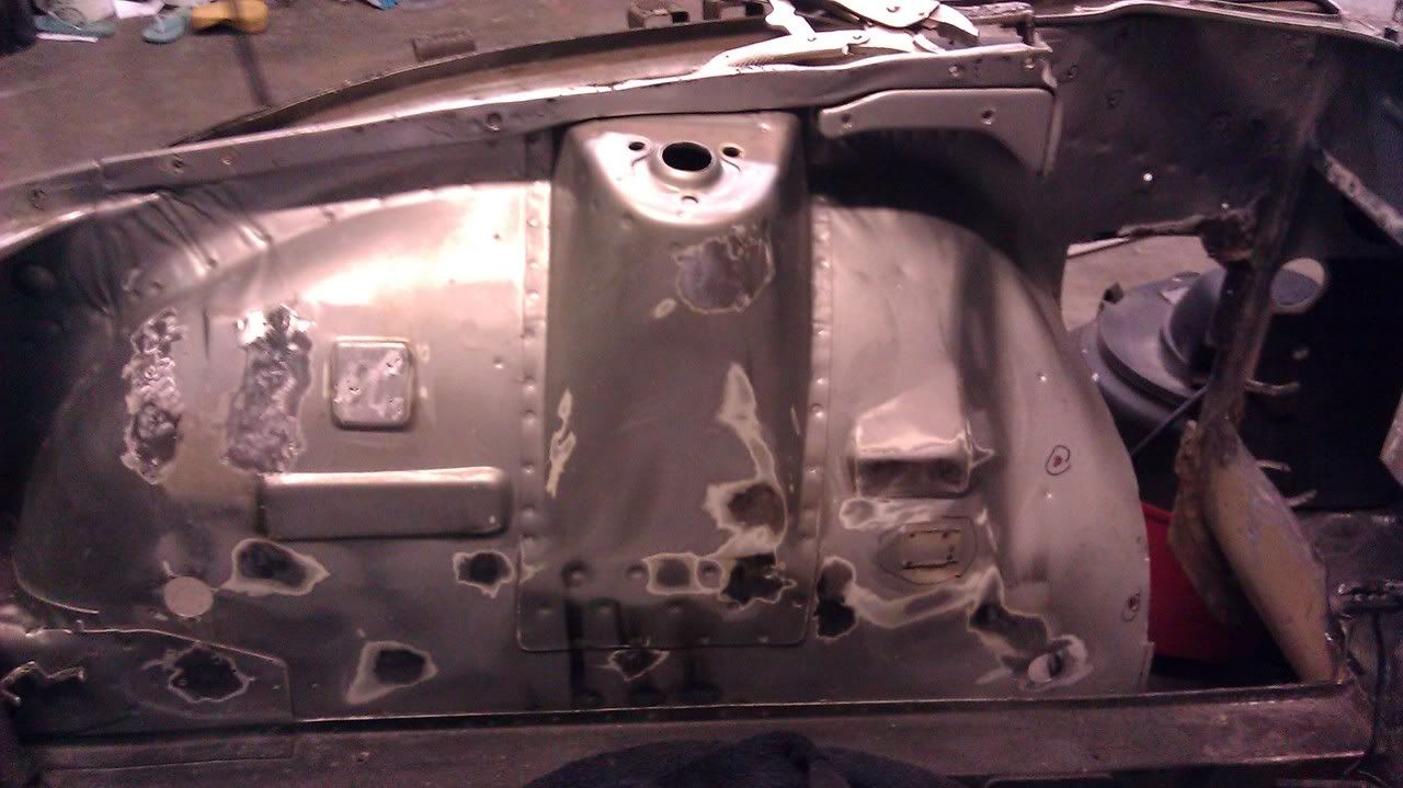

Finished welding up the passenger side... need to revisit some areas still.

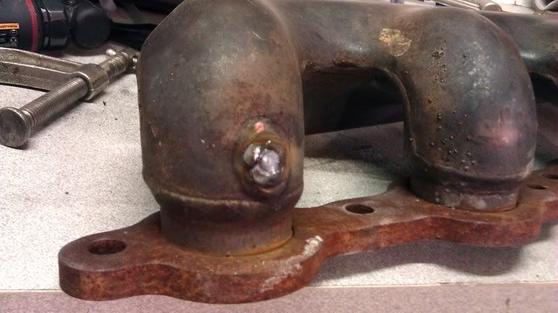

Welded up EGR and smog pump ports on passenger exhaust manifold.

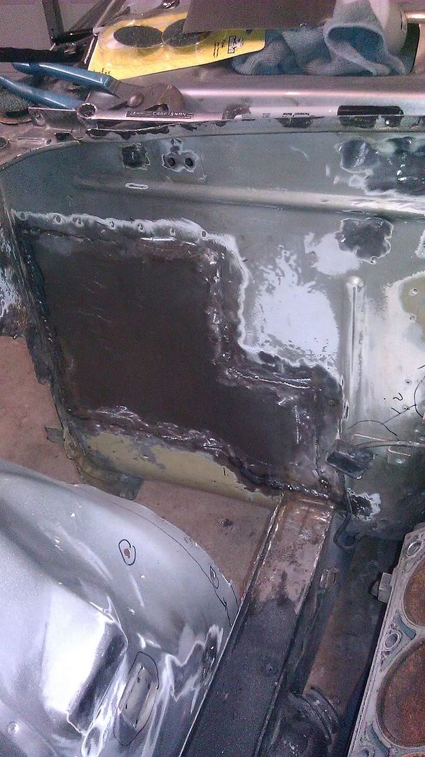

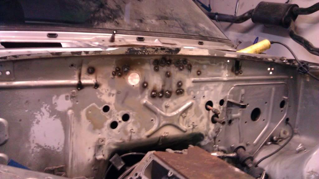

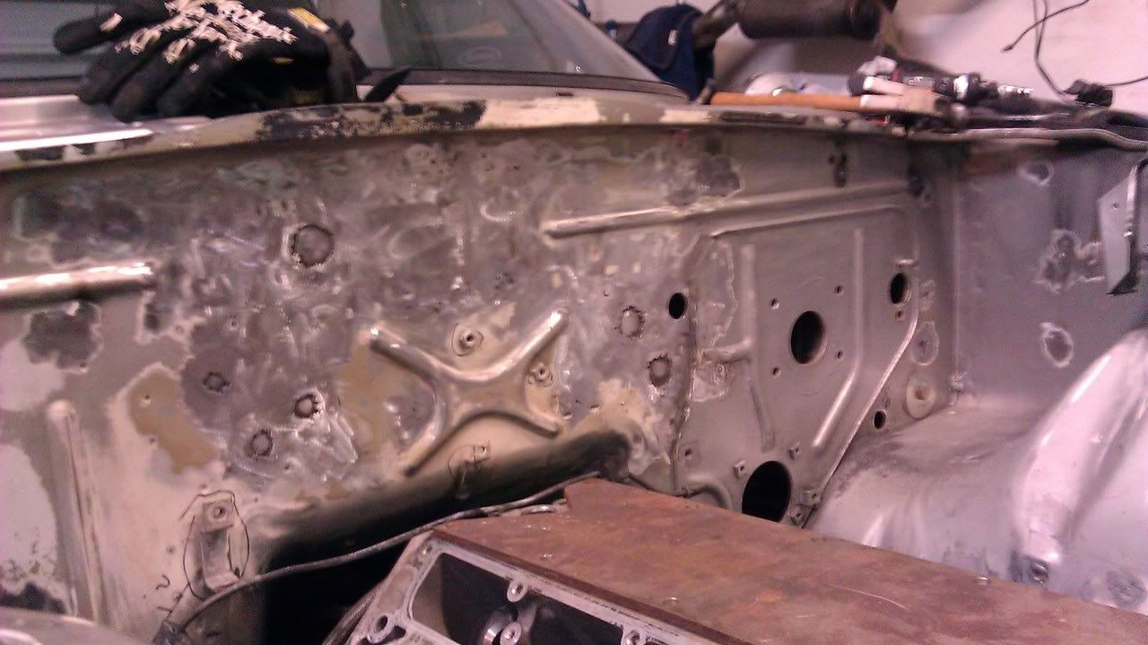

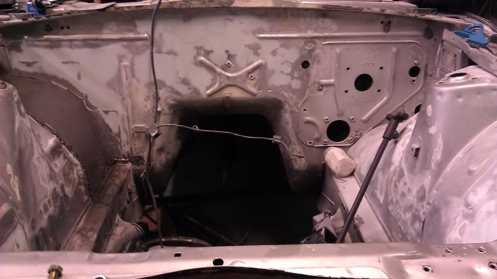

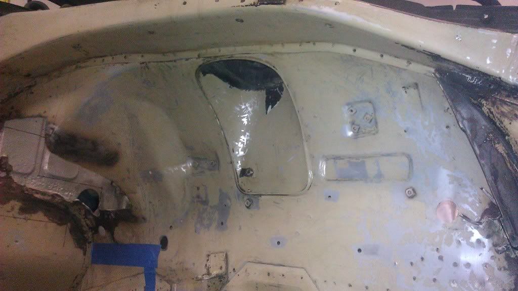

Welded up all the holes from the hood latch bracket and a few others on the firewall. I got pretty much all of the ones that lead into the cowl area. I still need to rip out the dash to get to the rest that are lower on the firewall.

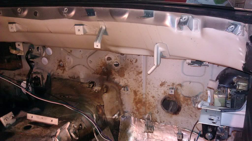

Yanked out dash, hvac, etc... (all the brown/orange stuff is left over insulation not rust)

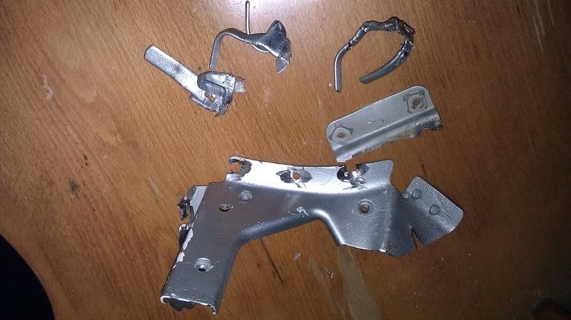

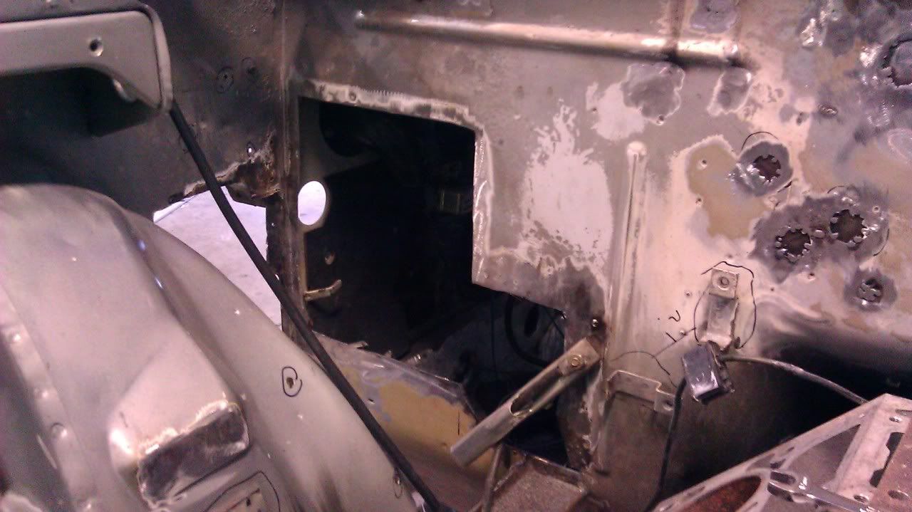

Cut off some of the brackets in the engine bay that were used for the stock motor.

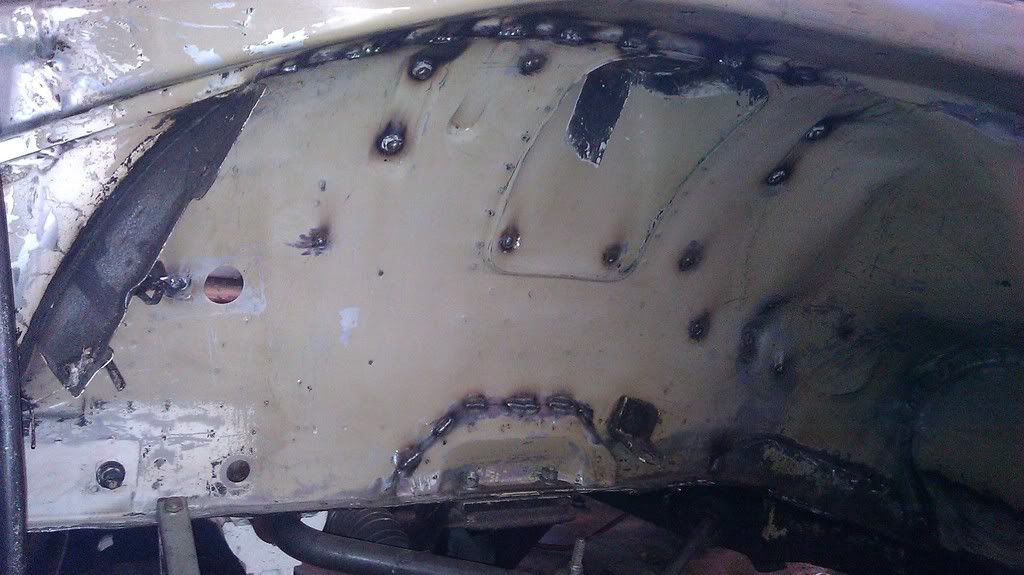

Most of the above came off the driver's fenderwell...

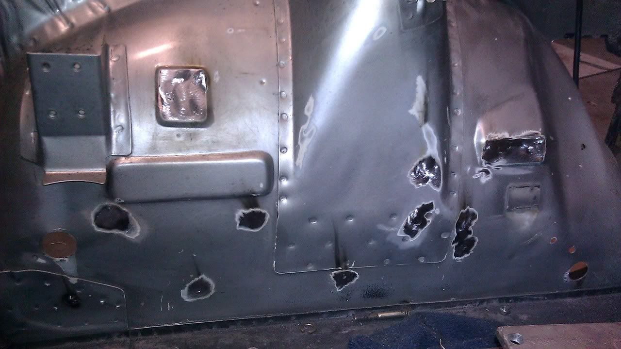

Made a few holes where the factory spot welds were, so they were welded up....

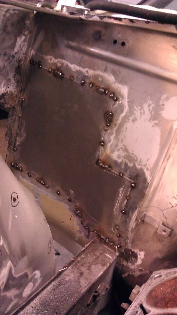

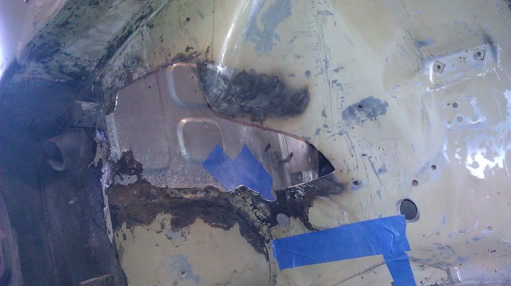

Tacked in the new firewall sheet metal.

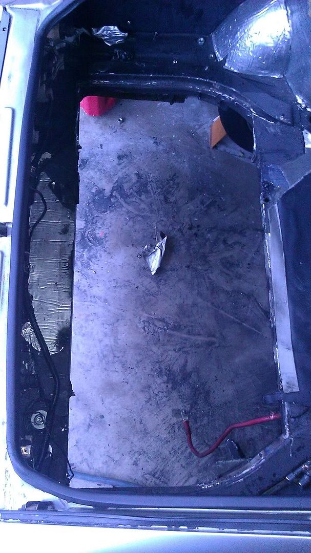

Pulled out Gas tank and battery. This is the next "mini" project... while I'm at it... Plan is to essentially throw the entire previous setup in the trash... A LS1 camaro fuel tank will go in its place. I'm not entirely sure what I am going to do about battery placement though. Of all the work on the car I was always most ashamed of this cluster f*@# back here.

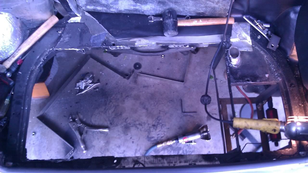

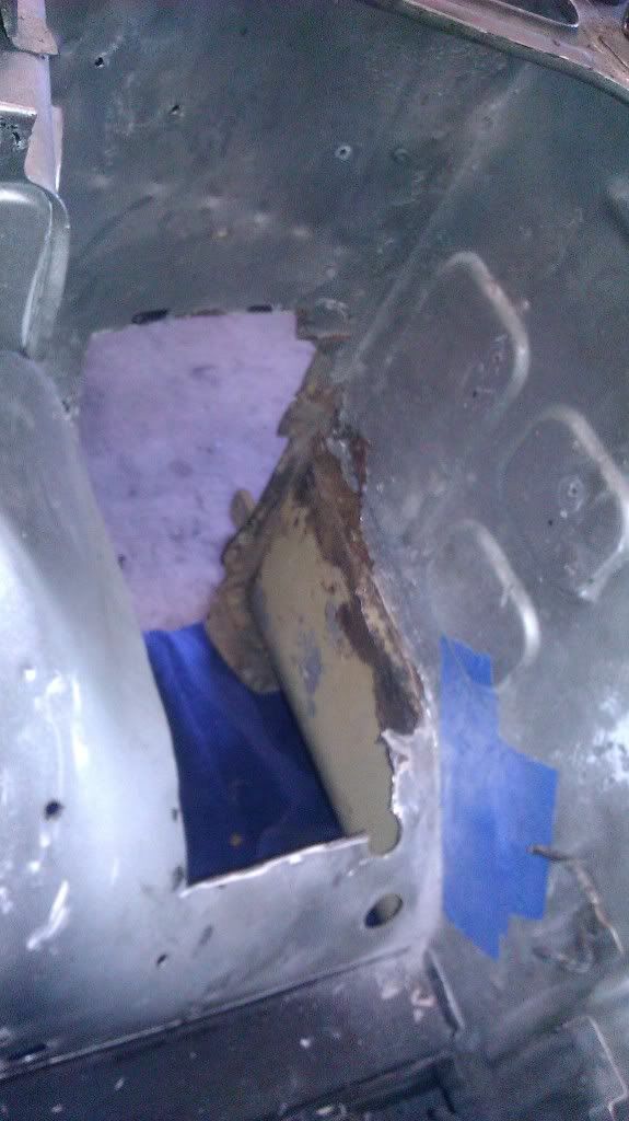

So I decided to cut some more holes in the car....
Go back to post 47 and you'll see what I am addressing here... or if you are lazy like me... here is a quick recap... When I initially pulled out the poorly installed roll bar hoop I just tacked in some sheet metal over the holes.. then car caught fire... and it was put off... etc..etc....
Previous temp "solution"....
and currently... just need to cut out some steel and weld it up.

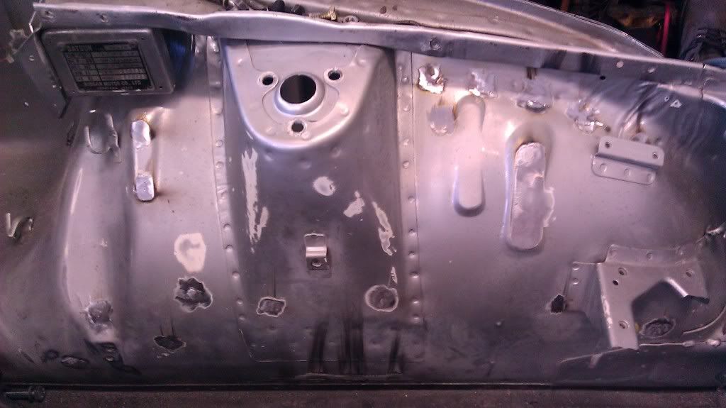

Firewall patch welds ground down...
and I made the fatal mistake of putting the car entirely on Jack stands.... this thing is never going to be done.... lol

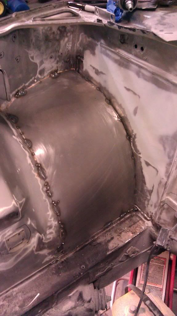

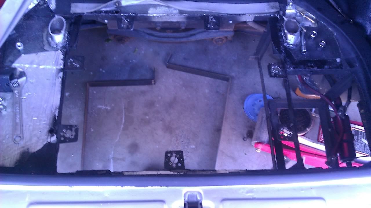

Bent up and welded a new section to finish out the inner fenderwell. I was thinking about moving the battery back up front but decided to keep it in the back. I still need to figure out where it'll end up, but we'll have to wait and see if I end up regretting that.
