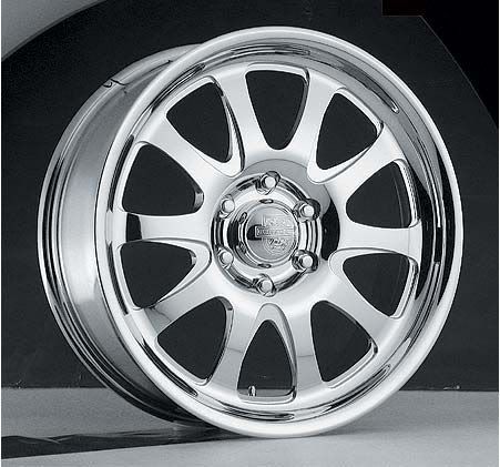

Centerline Tracer 16X8 0 Offset 5X114.3 Thinking that I should have ordered 16X7s because I now think that the clearance of the outer well will be an issue. Didn't think it through well-enough, and they don't take returns on made-to-order. It's is sort of retro, and I think that it will be just enough 'shiny' to tie into the other minimal chrome.

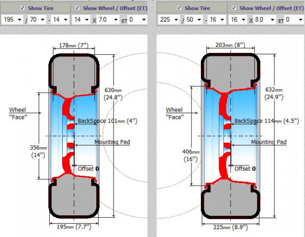

Someone else posted this link so I entered the stock tire size and the size I wanted to go with. Here are the results.
I'm going to measure my existing rims offset and check the clearance I currently have and compare it to these numbers. I hope the 225/50-16's will fit with no rubbing.

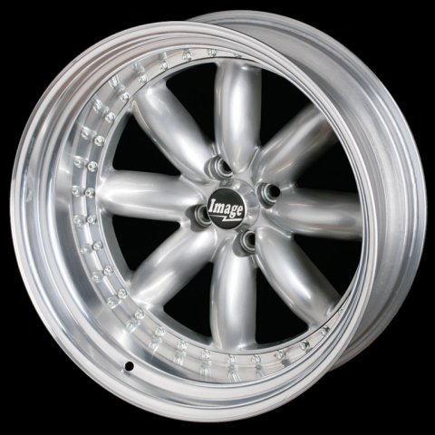

I paid 2500 Euro, thats with tyres and shipping from the UK to Ireland......A bit pricey but I think it will be worth it, Here's their website, all their wheels are made to order, you give them the dimensions you want and they will make it.
www.imagewheels.co.uk
thank you very much. I think I've made up my mind. i always wished enkei would make the RPF01's with a friggen lip. this is the closest thing i've seen to my ideal wheel....ever. but isn't 2500 euro like 4000 usd? geez
