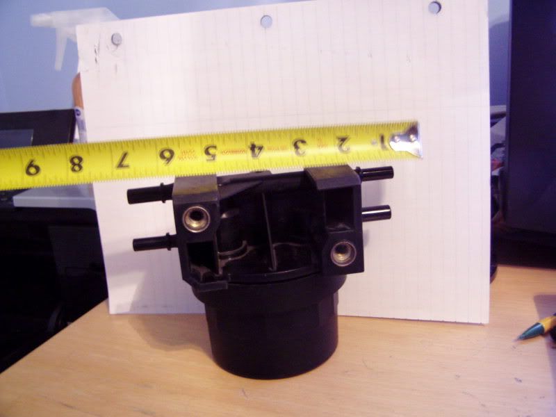

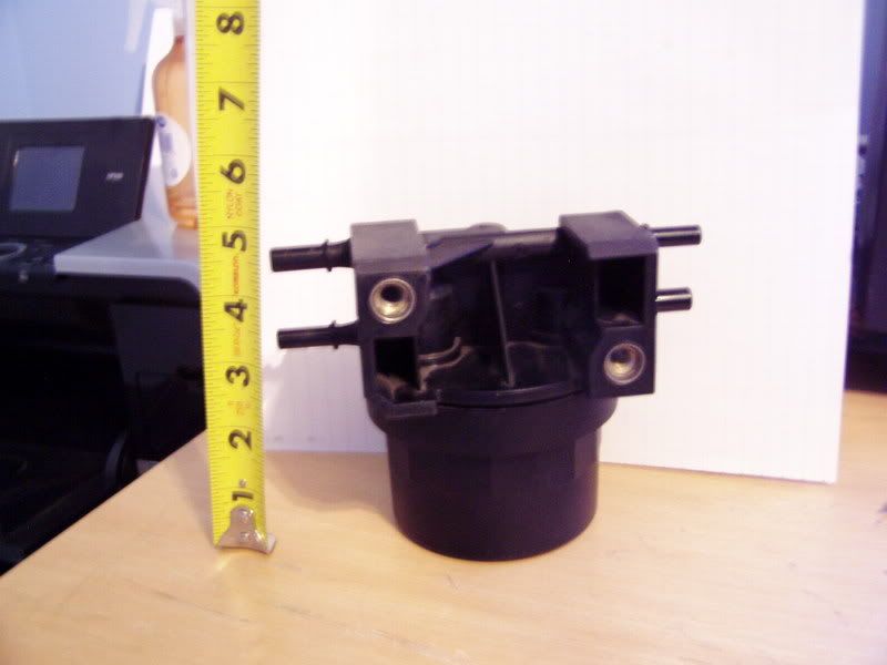

I just received my Ford surge tank. It looks like it will be a great fit for my Datsun 510 VG30 swap. I think it would fit well in a Z car too.
From what I can see it looks like it wll hold about a half a liter of fuel.
The one thing I can't figure out is the inlet/outlets. I pulled off all of the caps and it seems that not all 4 flow in and out together. The top one on each side is somehow connected to the bottom one on the other side. I determined this by blowing through them one at a time and plugging each of the other holes one at a time and all together.
There are 2 larger fittings and 2 smaller fittings. The larger 2 are connected to each other and the smaller 2 are connected to each other. I guess I need to try to put some liquid through it and figure it out. From what I see there may be 2 separate chambers inside of it. If this is the case, I don't know if it will work as a surge tank.

Besides the fact that the larger ones are your main fuel line and smaller are return lines, I'd guess there may be some sort of bypass valve inside that allows fuel from the return line to enter the primary feed stream if pressure drops below a certain point. That would be my guess, as I don't see any other way it would work. Use your X-ray vision and look inside! :)
