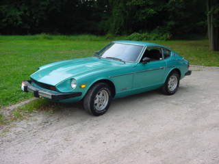

hey, this is a z im buying, but i will be changing the vents.the stock 77-78 hood vents are on the side of the front fenders. The stock 280zx hood vents are in the rear fenders, and the top of the front fenders. im removing the vents on top of the front fenders, and changing the front-side vents with 70-70 trans-am fender vents. 304894329.jpg
