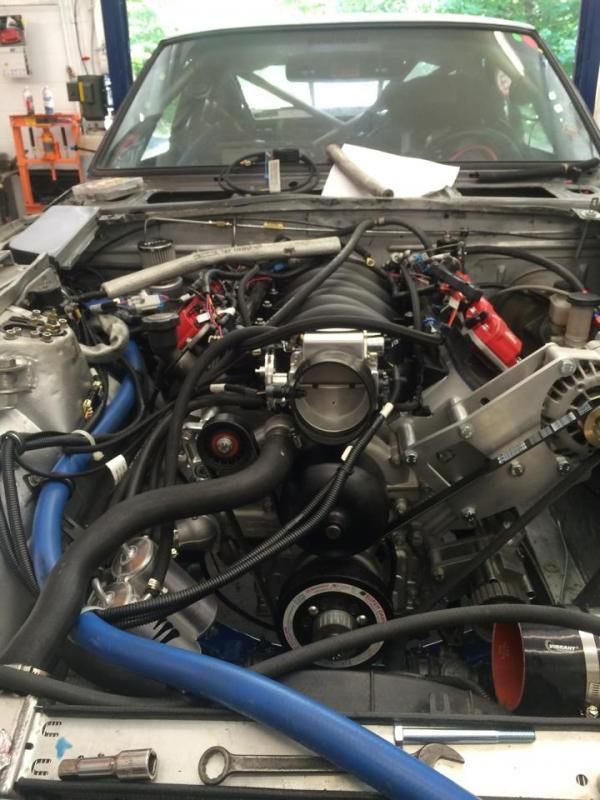

Total bust... The motor overheated while Matt Shue was doing part throttle tuning. We drained and checked the radiator and hoses and they checked out fine. We then checked the engine and could not find where the issue was. Matt was using a vacuum tool to test the components and we could not get the cooling system within the engine to draw vacuum at all... Here's the kicker... Zero oil in the water, and zero water in the oil. I'm perplexed at this point and more than a bit disappointed.
Share this post
Chemical test the coolant for combustion byproducts. Do a compression and leak-down check. Pop the radiator cap off and look for bubbles while checking leakdown.
I would have guessed that they were doing a poor job of cooling it while on the dyno but the cooling system not being able to hold vacuum is worrisome.
Share this post
The cap failed initially, which we fixed by swapping a cap from another car, but the bigger problem was it went from holding steady with no issues 190-198 to 234 fast when we shut it down.  Matt Shue caught it in time, but this doesn't appear to have been brought on by anything associated with the dyno.  Car didn't make a SINGLE W/O pass.  He was adjusting idle and had started working on part throttle drive-ability... as in like 5 minutes worth of driving on the dyno... MAX.

Chasing down a leak in the coolant system. Spent several hours over the last few days pressurizing the system. I'll continue tomorrow, but I think the motor is going to have to come appart. Ain't looking good.
Share this post
Update, We pulled vacuum after relocating the bleed tube for the steam fittings and the motor now has no air pockets.
Also, as I suspected, pulled the trans and the crack at the rear oil galley plug Jamie fixed actually cracked on the back of the block as well.  Motor is strapped up inside the car and the car will go to Jamie Taylor to address this and a few other minor issues as well.  Pics on my FB wall at Mikes Hobby shop.
You guys who are scratching your heads should know a few things... The internet is filled with stories of LS aluminum blocks CRACKING.  That's number one.  Number two is that the area we have seen the damage on this, a BRAND NEW GM block is VERY common.  That Galley plug has a torque spec of 44# which is about 26# more than I set it to (18# with loctite thread sealer).  One of the more common ways to damage the block is improperly mounting the block to a stand (which we never did the whole time I had the engine due to the issues with the FIRST LS motor I had (See posts circa Feb 2015).  Another is by pulling the transmission into the motor with bolts with an improperly aligned transmission/bellhousing (if not factory)/Clutch kit or incorrect Pilot bearing.  Again, none of this applied to me.  Another, the more likely cause is that it was dropped at some point from the "manufacture process" to the "Mike received the block" process.  It never was dropped while in my possession.  So why did Mike get yet another block failure?  We're down to two things... GM blocks that did not pass the "factory production" line spec were pulled off line... I can't prove that the blocks were resold, but when I shared my serial number with someone in the know, the answer (off the record) wasn't good.  So buyer beware.  it's almost BETTER if you buy your engine out of a wreck and rebuild it, apparently.  The other of the two things... The rear of these blocks is fragile at the oil galley plug on the drivers side, and the starter mount base on the passenger side.  The casting on these blocks is rough, as you are all aware, so just be careful handling them.  I'm hoping this is the last of my issues and I'll actually get to turn some laps in my car by July/August.

It has a lot to do with the way you mount the back of the block to a four arm engine stand.  Stay away from mount holes near the BOTTOM of the block and make sure the bolts are appropriate METRIC size steel with appropriate length to penetrate the full depth of the hole and then take up the "space required with approprate steel flat washers so you don't bottom the bolts out in the holes.
