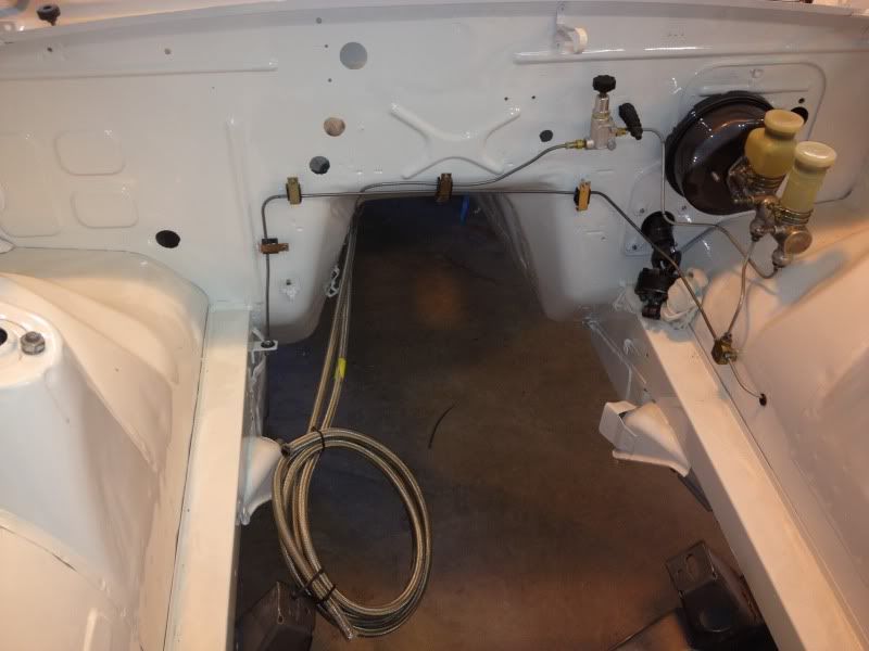

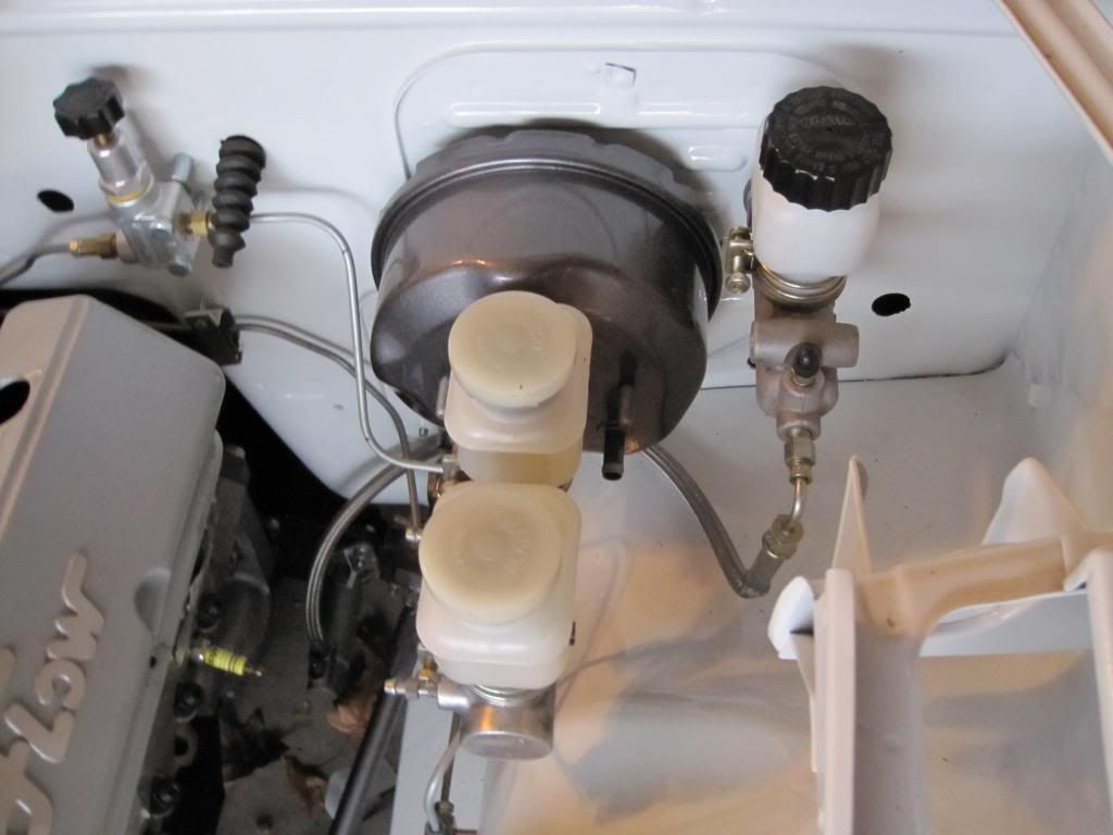

Going to start plumbing the car this week starting with the brakes. Just a note the brake booster from a 73+ will not properly fit a 70-72 body. Same with the pedal box. I began modifying the fire wall and didn't want to chop too much into my new paint, so I picked up a booster for a 72. The Tilton clutch master would also interfere with the booster. Hope this isn't an issue with the AZ brake conversion. (worked well with the 73 booster which is larger)
Pics to come!

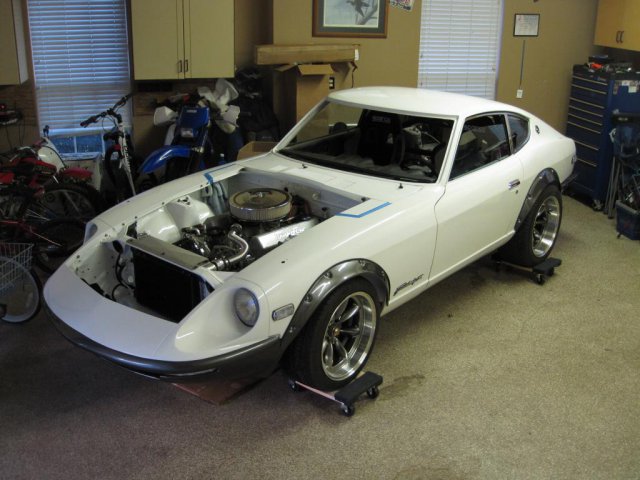

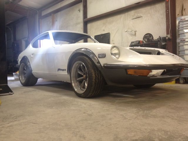

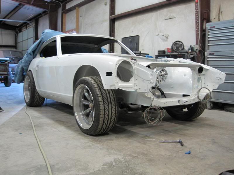

Here is where we stand as of today. This thing has really gone overboard!!!!
g z3_zpsc06aa520.jpgIMG_0254_zpsf9b77bb9.jpgz1_zps197ab790.jpgz2_zpse77c3b9c.jpggoing on, one fender, tail lights in, Holley EFI placed on intake.IMG_0256_zps460668f0.jpg

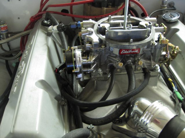

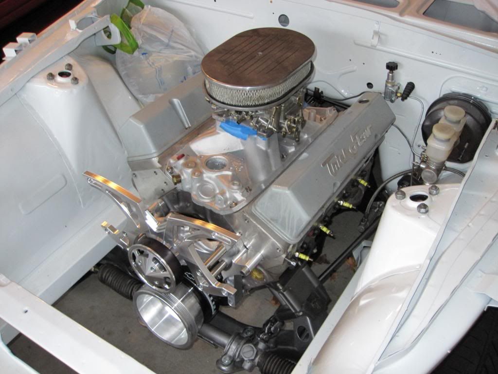

Can't post pics at this time (don't know why???)  I'll get some posted ASAP.  The car is now running, sounds bad a$$.
Ran into some issues.

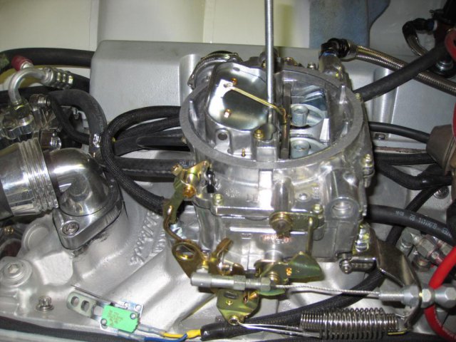

1. Holley EFI, ECU was dead, so no EFI on this one.  Went with an Edelbrock 750 electric choke, the ole "go to carb" works flawless.
2. MSD E-Curve distributor.  Worked for a moment of sputter then nothing, not a damn spark after trouble shooting it.  I'm goig to ship it to MSD for repair so its to be determined.
3. KEVKO oil pan, this one is JUNK!!!!! Bolt holes are too close to the side of the pan and cannot be tightened resulting in a massive oil leak.  I'd NEVER recommend these pans to anybody.
