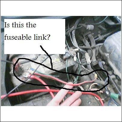

The wire from the positive terminal of your battery is the positive voltage feed for the EFI control unit. The control unit has it's own positive and negative voltage source. The EFI wiring harness is a whole separate harness including voltage feeds directly from the battery. The connector in the negative line is probably just so the battery cable can be removed without having to pull the entire EFI harness out. In the day, the positive probably had one also. (I'm guessing) Problem is, the battery cables have probably been replaced once or twice during the thirty years since the car was made. Aftermarket battery cables generally have only the one thick wire. (this next part I'm just guessing so don't take it as gospel) I think, one of the few applications that do include a second smaller wire is for fords, and that wire is a fusible link on those fords. So... someone may have replaced the cable with one that had a fusible link. I'm not sure where/how the EFI control unit is fused. Mine does not have a fusable link or inline fuse on those two wires. Mine are connected directly from the battery. That is how it has always been and I never questioned that it needed one. I think short protection may be provided by the FI relay. If anyone knows better please speak up. A good look at the wiring harness may provide an answer. Hope this helps
right now I'm starting to think it will be easier to buy a used EFI harness and throw out the old one. but i don't know anymore. I will try and wire upp my efi harness directly to the battery, and ditch the stock battery connections, and hard wire it in

I have one that came with my factory service manual as well. The schematic for the 77 and 78 both show the hot (positive) going from the battery to the fusible link on the inner fender. The schematic for the 76 shows a hot running directly from the battery to the EFI control unit. This is how my car is wired. My car was manufactured in 6/77. I'm guessing it has the harness shown in the 76 schematic. FYI the schematic does show a fusible link inline in the hot wire leading to the EFI control unit. (although no indication of amp rating) I have a 78 parts car and I swear it is wired the same way but will be checking soon. If you decide to swap out the whole harness, bare in mind that there are differences between years in the harness, the control unit's pin out, the AFM and automatic versus standard tranny.
