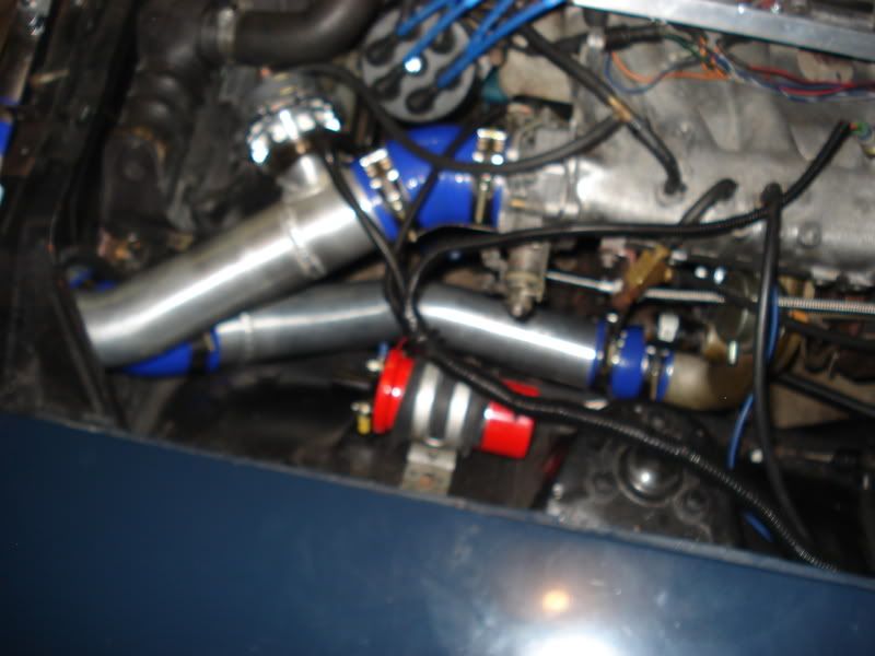

I just stuck in a 280zx turbo engine with a HY35w about 2 hours ago (into a 76 2+2).The Holset is out of an 02 Dodge 2500 pickup. The exhaust manifold outlet is impossible without rerouting the air conditioner lines and a big alteration on the firewall bodywork. I am going to to cut the outlet rotate it and reweld it...or use an ABS stainless steel adapter (waste plumbing stuff) with mucho RTB or stove cement. Obviously the design changed after 02 and thereafter now we have a v band rotational thing on the outlet. The intake is so close to the shock tower that I will either have to go inside the wheel well with the intercooler piping or whack off some of the input. But, that`s part of the fun of it...adapting to unexpected realities. Get a post 02 if You can! Otherwise it is a cheap way to do it--got Mine for 335w/shipping. Enjoy, Roger
