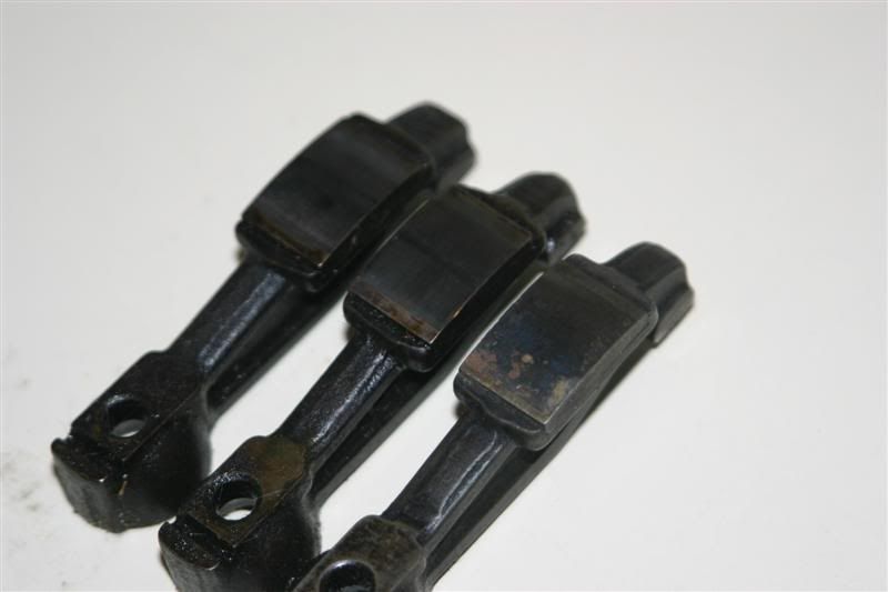

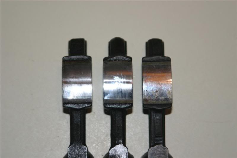

Guest Widebodys30
Those cam pad surfaces there are toast, buddy. All 3 are. You can't think those are OK in any scenario. Engines are like a huge Rolex watch. Would you use a jewel with several teeth missing?
Those scanning electron microscope pics can't be argued with.
Even if they picked the "worst" and "best" pics for advertising,
what they show going on has me sold. Oil changes are so expensive now anyways, 20 extra bucks won't kill us, and the fact you can(if you wish) nearly quadruple the old 3,000 mile rule?
Guest Widebodys30
Some advice, from the netherworld of the internet:
The surfaces of the wipe pads needs to be dang near PERFECT. In no instance is ANY damage OK for use. If you can feel ANYTHING with your fingernail run across it, something is not right. Let alone actually being able to SEE it with your naked eye!! If it is VERY minor, a fine scotch brite pad, or 1,000+ grit sandpaper might polish it out. Otherwise get them rebuilt/reground.
From what I am reading @ here and other places, properly installing a Z cam is something that WAY too many people cut BIG corners on, and don't do 100% correctly, very often at all. On such an insanely important procedure! I see it's rather time consuming on OHC Datsuns, but SOO important! Perhaps because they don't want to buy different sizes of lash pad, or take the time, or something? Chances are, EACH lobe/valve might be different!
You'd rather not bother, or spend the $$$, and within 10,000 miles wipe that $500 Cam and rocker kit you bought? :icon56: Talk about having more $ than brains or skill. People who do this kind of garbage, please see my Sig, and don't act surprised when you wipe a lobe, or ruin wipe pads on your rockers, and fill your oil with metal shavings and particles. ZINC won't cure your problems.
Sorry, I get annoyed at pure mechanical idiocy, and it is so prevalent and rampant. Like GM V6 cast alloy pan oil drains tightened to what has to be 150-175 ft lbs. I've seen it over and over. Seems REALLY common on Chevys.
