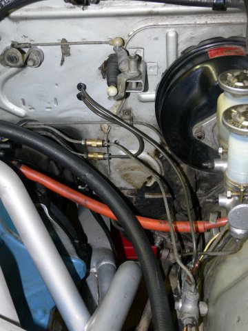

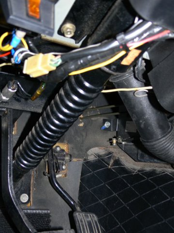

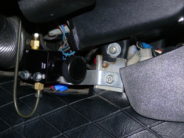

One time when I had the intake manifold off I mounted the prop valve under the dash as part of a "while I'm at it" project. The bracket is just some aluminum bar from Lowes that I bent using the bench vise. First I formed the tubing for the "under dash" part leaving the part for the engine compartment straight. That was then inserted through the two holes I drilled in the firewall. The intake manifold on the L6 needs to be off for the tubing to have a place to go until you can route it to the distribution block. I don't know about clearance for a V8.
Originally I had the prop valve mounted on the front fender inside the engine compartment, but it was a hassle to fine tune it on track days. Plus, as the day progressed I found that the optimum setting changed. Obviously it's easier if the valve is accessible inside the cabin. Also, while I don't usually drive the car in the rain, now and then I get caught out unexpectedly and on those drives I turn the valve out 1/2 turn to be sure that I'm not doing pirouettes on public streets. To Jon's point, I could have done this with the valve in the engine compartment, but it's a lot easier to do without having to pull over and raise the hood, especially when raining.
Edit 1: I had originally wanted to mount it the way cygnusx1 did, but like you, didn't want to pull the tranny. When I converted to FI and had the intake manifold off, this was the easier path.
Edit 2: Like most "while I'm at it" projects, this one took a lot more time than the pictures suggest. Finding the metric unions here in CO was a pain, and let's just say that the brake lines in the pictures weren't the first ones I tried :)
