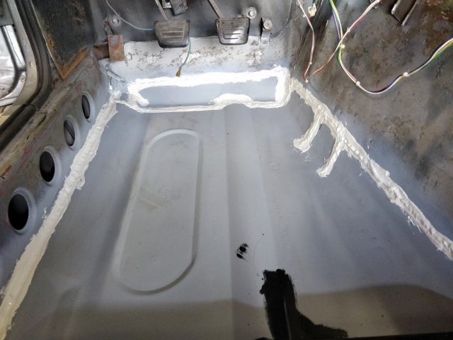

Seam sealed both floor pan weld joints with 3M Urethane Seam Sealer. Used a trimmed acid brush to goop on the sticky, messy, stuff.  Next up will be painting the pans with POR 15 black.  I don't care too much about how it looks as this all will be covered with carpet.

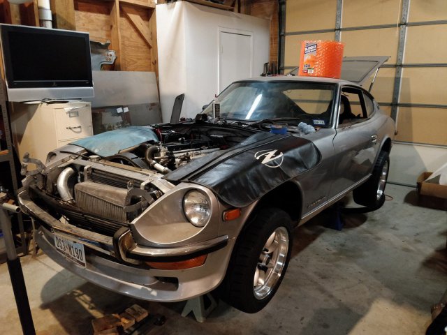

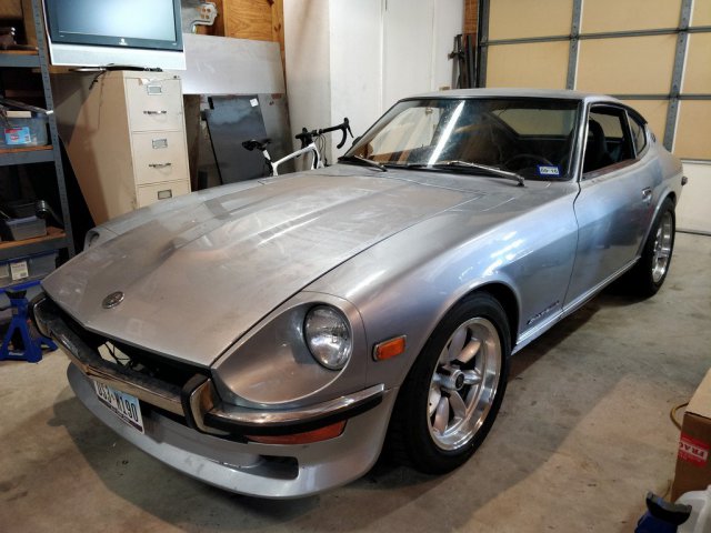

This is the car as it sits today, pretty much ready to start.  All I have to do is put oil and fuel in it.

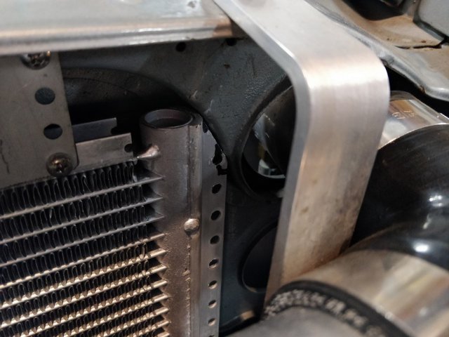

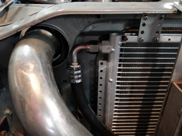

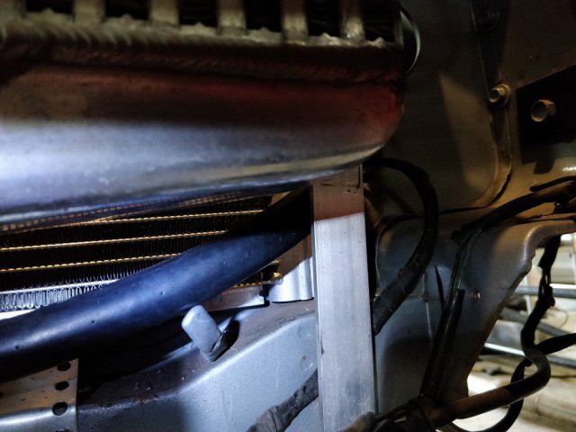

The 24" ac condenser is a tight fit but it works!

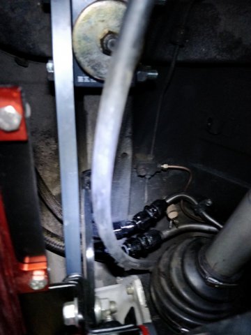

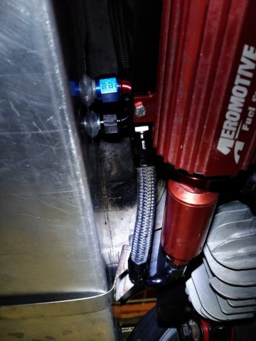

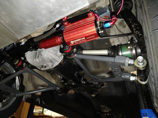

Aluminum fuel tank and lines are installed.  I had to polish the inner flares, same as I did back in 2008 due to purchasing cheaply made stainless pipe.  I'm going to get rid of all of it because I don't want to do that again!
IMG_20190309_171135-picsay.thumb.jpg.01dfaea40bb44e608a66975c8e3e4594.jpgIMG_20190309_171255-picsay.jpg

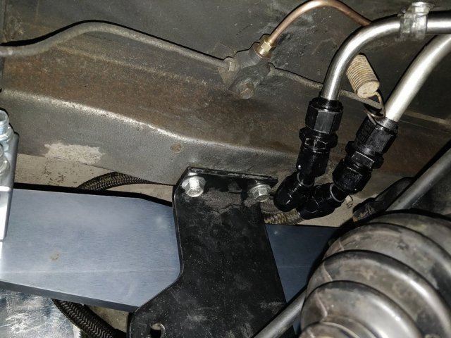

Here you can see my TTT LCAs, new fuel pump mount, and barely see the TTT mustache bar.  The main reasons for the LCAs and mustache bar are for clearance to the half shaft boot.  Note to self:  Don't forget to tighten those damn LCA pivot bolts before I get all excited when the car starts!

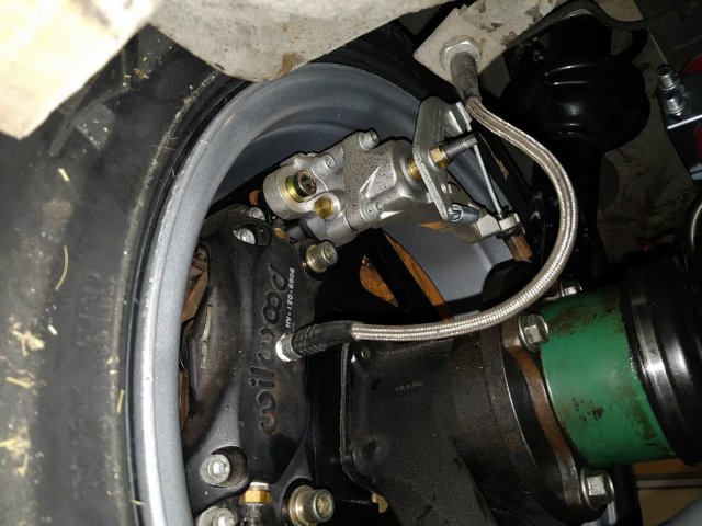

Back side of Wilwood parking brake.  I hated dealing with the hydraulic line lock.  It's just not a good solution for a street car.  I went thru three of them that failed due to leaks before I started looking for a better solution.

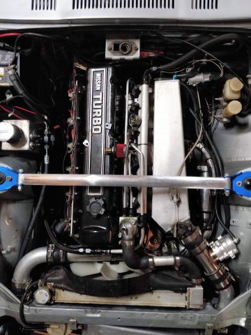

A recent photo of the engine.  It needs a lot of clean-up, wire tucking, etc. but it runs and drives reasonably well given my novice tuning abilities. I need to fix a few things that are bugging me before I get it professionally tuned like reasonably sized catch cans and a better IAC solution.  The current IAC setup works ok at idle but turns into is a leak when the turbo spools up, slowing boost response.
