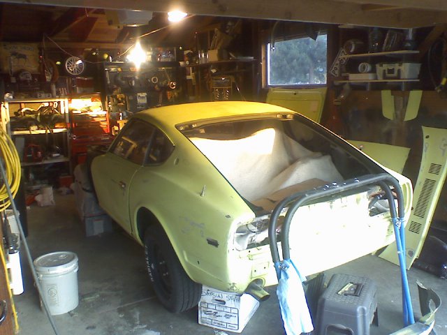

oh and here's a picture of my garage with the project in question
dont do maaco
single stage means no clearcoat
single stage also fades faster and limits polishing out the scratches regular washing causes
the reason why they want the car together is cus they dont do jams under hood inside ect.
They also dont care about dust
If the car is together and not masked properly dust will ruin all your nice prep work
Nobody likes pimpled paint.
Paint it yourself if you know how to work your gun and have access to the materials if not save your money and pay a better shop 90% of the shops out there are better and your baby deserves them
The quality of Maaco jobs varies from shop to shop. Take a look at the finished paint jobs at the Maaco you got a quote from. If you are happy with the quality, I'd say go for it. As you said, your car isn't perfect, and you want it back on the road. I think the "single stage is bad" argument is invalid, since your car came with single stage from the factory. Cared for properly, single stage paint jobs can last decades.
I went through the trouble of doing it myself ( here: http://forums.hybridz.org/showthread.php?t=104557 and here: http://forums.hybridz.org/showthread.php?t=105466 ), but I can tell you that it cost way more than $600 in the end, just for supplies. And that's not counting the number of hours pre AND post paint that was required (after all, time is money).
Check out some of the small paint shops in the area, some of them are in the same ballpark on price. I had mine done in a small shop in AZ and got it painted with the stripes cheaper than maaco. It not a show quality job but sure looks good driving down the road.
Prep is everything. Take off anything that needs masked off if possible. That is where most flaws are. It really depends on what you want.
I agree, it does vary from shop to shop. There's a local Maaco here that a friend of mine took his Eclipse to afew years back and had it done for 1000$. That was all the door jams, engine bay and clearcoat. It came out really nice, I was surprised. I'll probably take the Z there when it needs a spray.
I've seen some pretty good Maaco jobs.
I'd say before you start thinking about spraying it yourself, look into the expenses in creating your own paint booth. You want to make sure you have a proper space to spray it safely and correctly. It can be quite a hefty sum of money just to set up the booth. Do some google searches on home paint booths and get some ideas. Lots of people use wood framing and vinyl sheeting with good fans, etc.
