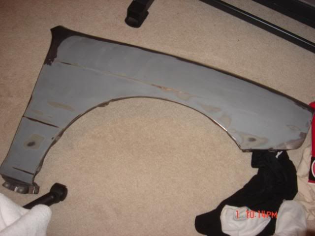

...sanding down just ONE fender is a toughass job (trying to fix up my current ride, Acura Integra LS year 2000 model). It feels like the 400 grit sandpaper only lasts for 5 minutes of rough sanding. The fender that I'm talking about is an "extra/used/stolen/god knows how this guy got it" fender that I got from a craigslist dealer for 20 bucks. Not the best looking fender (has a little bit of rust but nothing serious) but it looks decent and dent-free enough to be able to replace it with my old one (acquaintance of mine damaged it by ramming my car into a deer on Stevens Canyon :sour: )

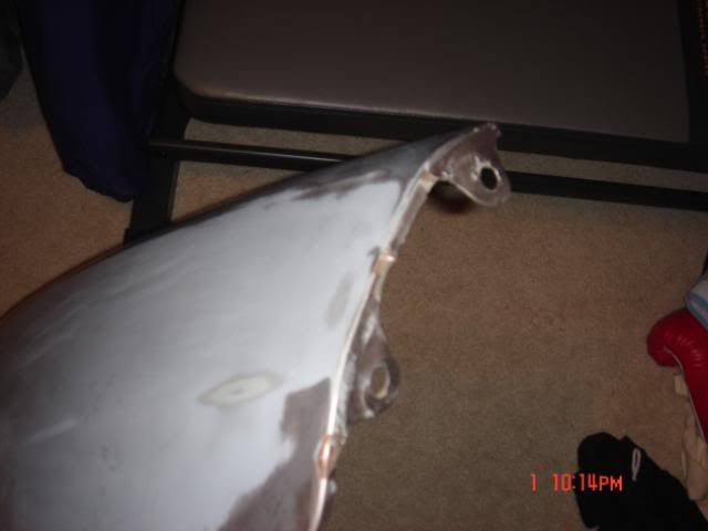

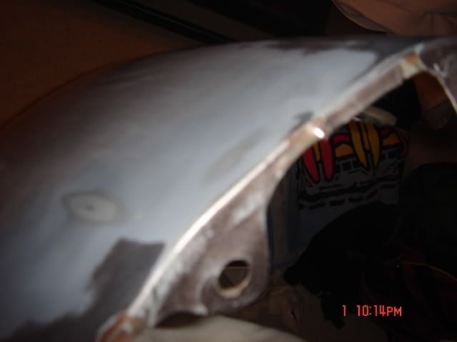

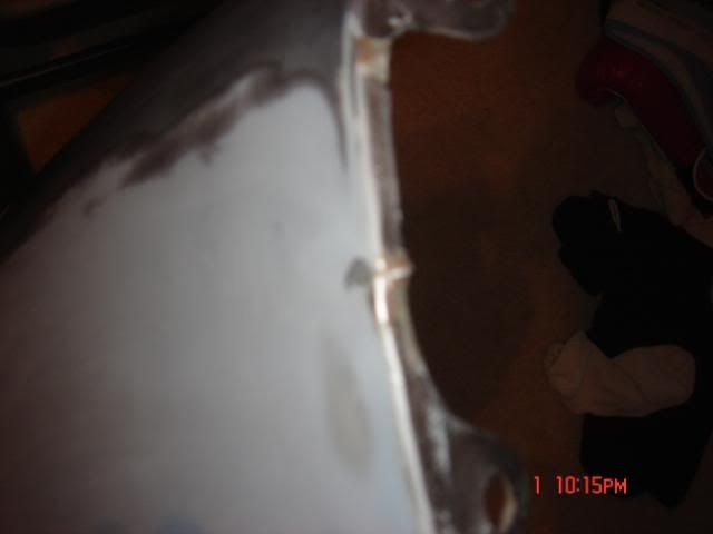

ANYWAY, I'm almost done sanding down my extra fender, but I'm not sure what to do about the little cracks on the edges. I'm not entirely sure if the cracks will be noticeable once I install the extra fender on my car anyways. But it's always better to be safe than sorry, so perhaps I should NOT cut corners and do everything I'm supposed to do. Oh, I did sand all the way down to bare metal on parts here and there so I got self-etching enamel primer from Kragen's. Would it adhere with the factory primer?
Oh, and here are the pictures for reference!

You sanded it with 400 grit, from the factory finish to that? Yikes. Normally you'd start in the 80 grit range, do some hammer and / or bondo work, then 120, repeat the bondo, 220 grit, spray some primer, block it down with 400, tack it off and spray your color.
I wouldn't fret about the bare metal, just prime it. Etching primer is funny stuff, to me anyway, I'd go to the auto paint store and buy some standard aerosol primer - whatever they recommend. I don't think you can always put it on top of other primers. Caveat emptor.

For the cuts in the metal - I had the same thing on a fender. I hammed and dolly'd the area, tack welded it from the inside, and said "good enough". On the Z, its behind the headlight bucket so nobody sees it anyway.
