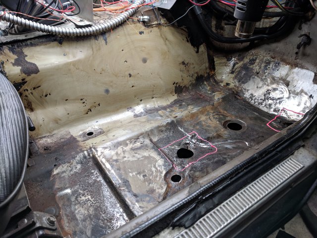

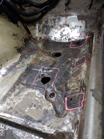

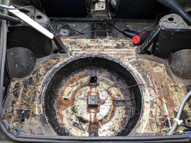

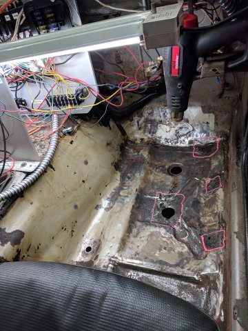

That said, today was a pretty product low key garage day. I now have my flex fuel sensor installed though my wiring isn't final (just wanted to make sure it works). Also got my new IAT bung welded on. Tomorrow I think I'm going to make a run to the parts store so I can sort out my vacuum lines a bit better, as well as maybe find some steel tube to allow me to add my new bypass valve. I also spent some time working on my accel enrichment curve and now it's much more responsive with throttle stabs. Not perfect, but I need my VE table to be more solid before I fuss much more. And in case you didn't see it elsewhere:
I was thinking I'd just cut the whole thing out, but I don't want to grind around down there too much with the tank in place, but then I realized I can just drill out the spot welds. Might tackle that tomorrow. We'll see. I know eventually, possibly next winter, I'll be installing a fuel cell so anything I do now is just temporary until I have a final floor placement with a cell in place.
A small side note: Though goof off is primarily acetone, it's definitely FAR better at removing dynamat TAR. By a lot. It's also only $2/gal more at my local Lowes.
