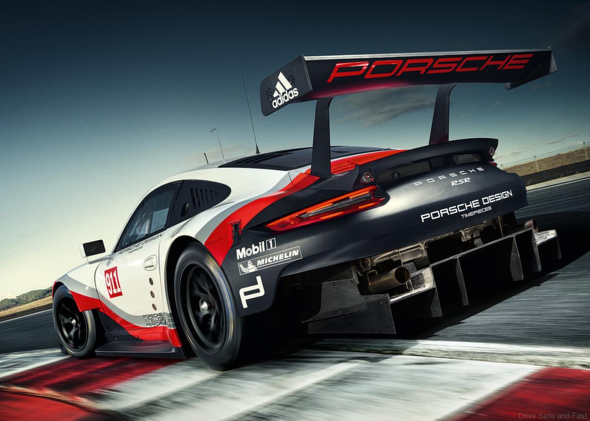

If you look at many of the Time Attack cars, the 911 RSR, etc you'll see that a lot of them just cut the bottom half of the fender off and leave it wide open. I have considered doing something like this, haven't committed yet because it's pretty drastic, but will probably get the itch one day and attack my car with a cutoff wheel (again).
http://www.dsf.my/wp-content/uploads/2016/11/porsche_911_rsr_2.jpg
Edited by JMortensen
On 5/13/2021 at 1:03 AM, markrolston@mac.com said:
thanks for the advice. I'll certainly do some testing first. Anything I do will first need to be subtle enough to not force a drastic change in the classic form of the car. I'm trying to tread a narrow path between modern tech and an old-school car.
Yes, we need the Z to still look like a Z so subtle changes that actually work are extra cool. If the car is configured to run air from underneath front to back and use it to improve aero, other than via the usual obvious diffuser, then that would definitely be extra cool.
