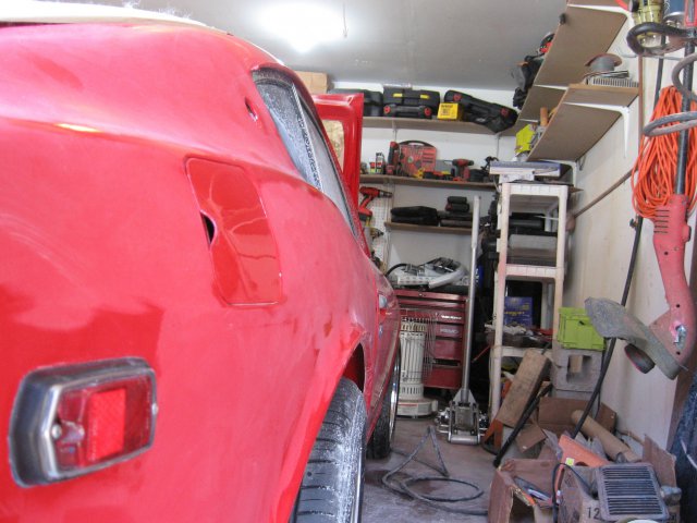

today i resprayed the driver side fender. 3 mist base and 2 heavy clear. here are the pics with just the base before clear.
here i layed down 2 decent/heavy clear coat. no overkill clearing is needed as it will run and be a PITA to sand.
heres a really close shot of the paintjob. minimal orange peel but a couple wetsand paper should handle the business.
i hate to waste paint like always especially when im done with the job and have extra still in the guns cup. so i decited to do some quick spray where prepping doesnt matter and layed it down without primer. lol. picked up the only pieces left sitting around and layed some under. its even got clearcoat on it. hahaha can ya see the traped dust???

I might suggest that you switch over to distilled water. Depending on your location, you will have some hard minerals in your tap water. If that water has any chance of seeping into the pores of the paint, it can and will etch the paint. At this stage, without any wax on the vehicle, introducing any unknown substance is a bit too risky.
Just my opinion... What you've done so far does look very nice. :icon14:
i think its a little overkill for distilled water. i know distilled water is the cleanest water for anything but i dont think the z is gonna stay with me for another 10 years so im using what i can find for now. alot of shops around here suggest the same thing and to use distilled water, i have not yet to see a paint job that has been effected by tap water from wetsanding. im sure the water around here is dirty compare to city water because i live outside the city and thers only farm fields around me. thanks for the heads up though..
anyone can paint like this. it just takes time and learning how to spray and adjust your paint equipment. im a do it yourself guy so its all still a learning experience for me also like i already have mentioned before.
i gotta be honest though, it does look better than some paint jobs i seen around here that shops do. autobody is such a PITA and underpay and customers rush to get their cars out while they dont understand it takes time to do a clean job. i rush myself at times also but i tell myself the thing aint going nowhere anyways because it doesnt have an engine. lol.
