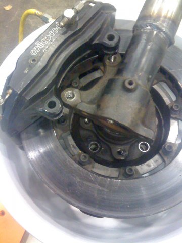

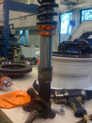

basically this is what im working on for the front, a threaded CNC tube pressed over the stock strut and than welded.
We are now working on the for the brake calipers, nothing to fancy but im sure it will turn out nice
Share this post
What's the eta on those items?
