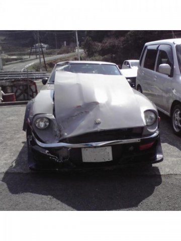

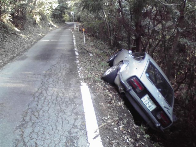

It has been a long time since I have updated this thread. My z ran for a while until off the road 6 months ago.

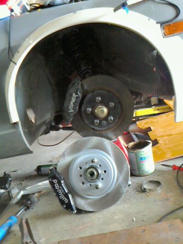

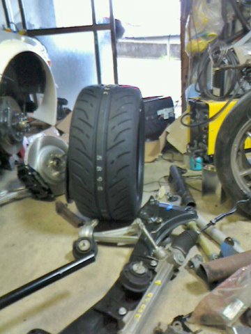

The front crossmember was slightly bent. Anyway new flares and front spoiler had to be made. I decided to put whole BMW front suspensions (Z4 steering rack, E36M3 spindles and tube arms).

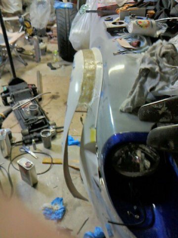

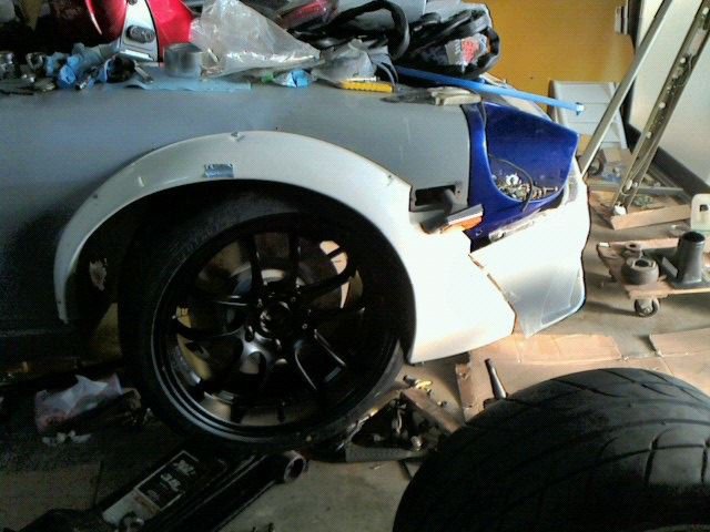

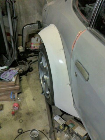

9.5J-18 with 255/35 hit Nissan works flares.

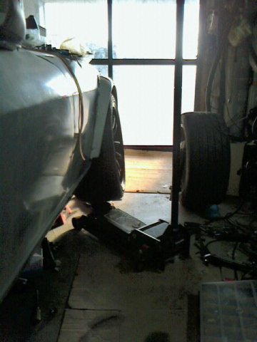

Rear flares fit properly.
Widen.

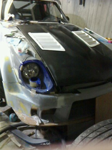

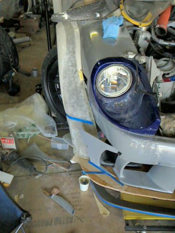

Current status.
