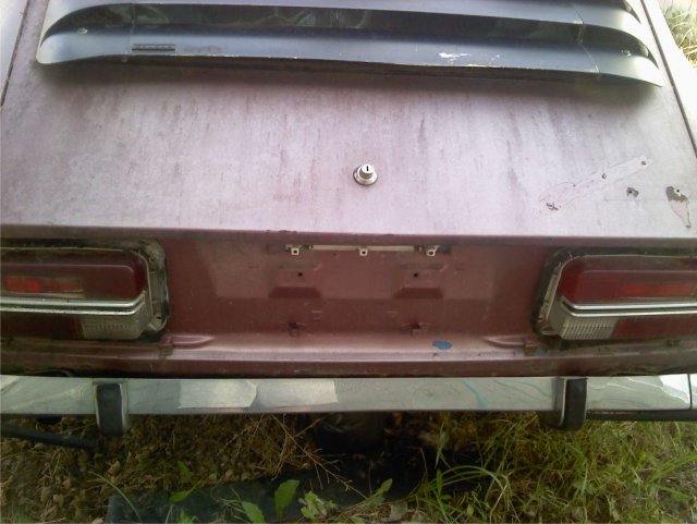

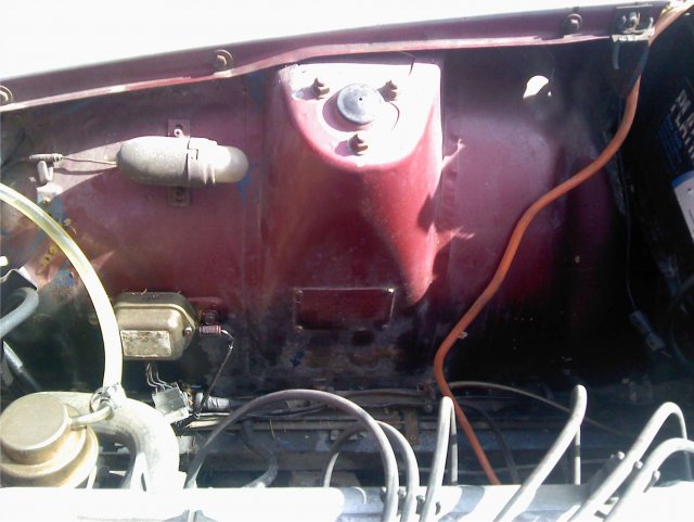

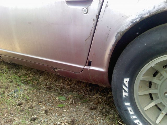

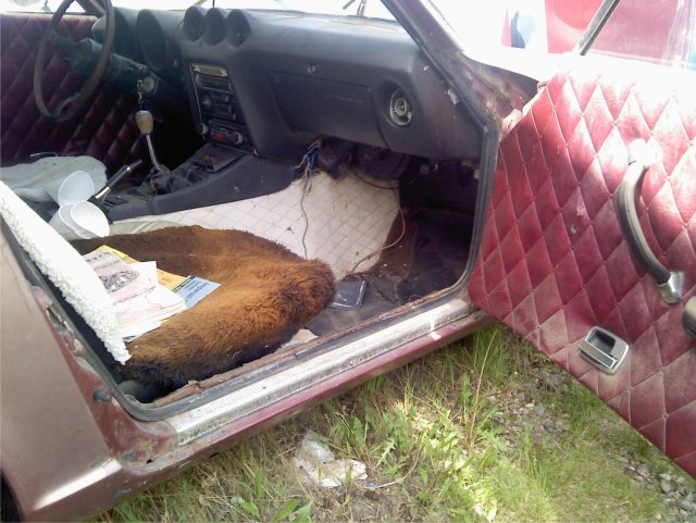

Hey guys i'm new to this forum but not to z's, I have an opportunity to buy a 240z which needs restoration for $1000.00 i was wondering if there was a place on the car i should be looking for damage like the frame rails or floor pans? i'll post some pics and let me know what you guys think.

The quarter panels are steel and part of the unibody. I can see rust on them in the pics. I would seriously question anybody who says an old Z is "rock solid" especially if its been sitting in the weather like that one. Don't buy it without seeing it first.
Sunny got most of the problem areas. Also check on the bottom of the hatch and on the body around the rear hatch area.
