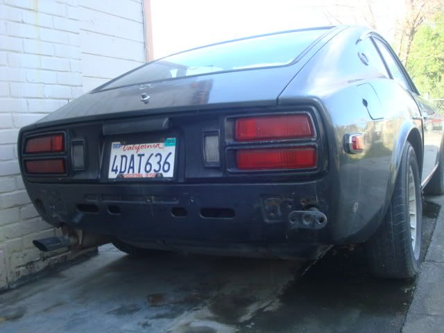

Hey guys! I have had my 260z [late model] for about 5 months now and am finally ready to start my build. Car was bought somewhere in June of this year, I bought it for 11 hundred dollars. The owner was pretty nice, he even gave me a spare trunk hatch and 2 boxes of parts such as gauges, hoses, carbs, etc. It ran bad, until we hit the highway at around 70 mph it was silent. I bought the car w/ the following problems; somewhat alot of rust near trunk lift/tail light section, brakes were bad and making loud clanking sounds, and the carbs ran super rich so that probably needed tuning or a rebuild. The car has some rust here and there and I plan on painting it w/ por 15 or just cutting it and welding some metal in its place.

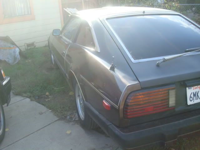

Reason why I haven't started my build was because I didn't have everything I needed. This will be a street car and hopefully a track car one day. Im not good with carbs especially dual ones so I decided to do a l28et swap. I just bought an 82 280zxt with an auto tranny last month with 110k miles on it. This will be my donor car. My hp goals are somewhere between 250-300 hp. Currently I have done a rear disc brake conversion(Modern motorsports brackets/240 calipers). I also have a wilwood prop valve, MSA turbo dp, and Act heavy duty clutch that I will install. I am really excited about this swap and I hope to share my build with all of Hybridz so some words of advice and encouragement would be much appreciated. My work schedule sucks and I gotta work every other day so I wont be on as much but I will post as much as I possibly can.
I have already started prepping for the engine removal by removing the radiator and hood.
