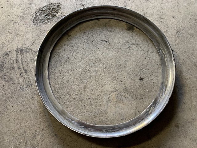

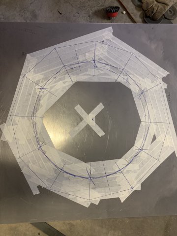

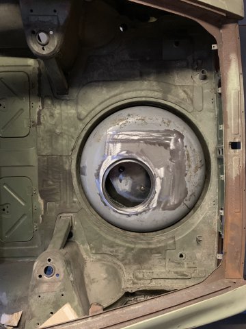

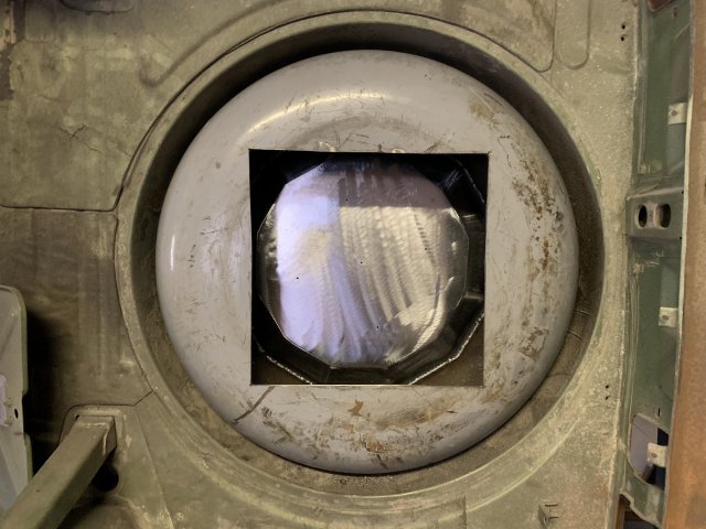

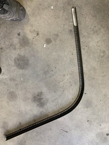

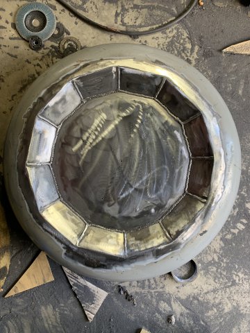

So moved onto the rear fuel tank fabrication, using the LPG donut tank as the basis

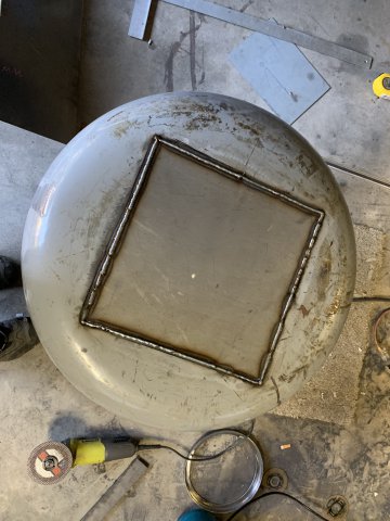

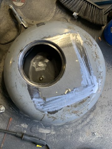

First was chopping 65mm out of the height through the centre aa well as removing the center tube section
Then it was a matter of fabricating a centre rise section to clear the spare wheel well hump
With the modifications, I’ve worked out it should be between 58-60 litres plus another 8-10 in the additional surge tank
All in all so far a perfect fit
See you all next week

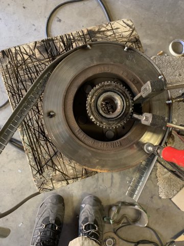

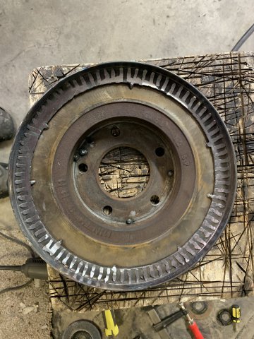

When necessity is the mother of invention

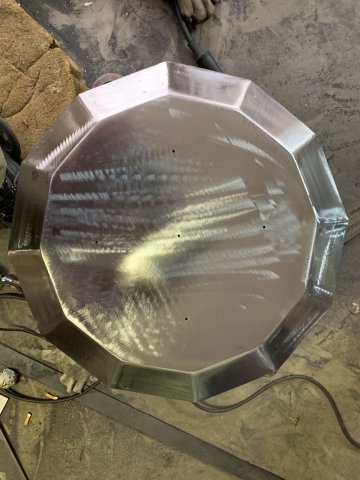

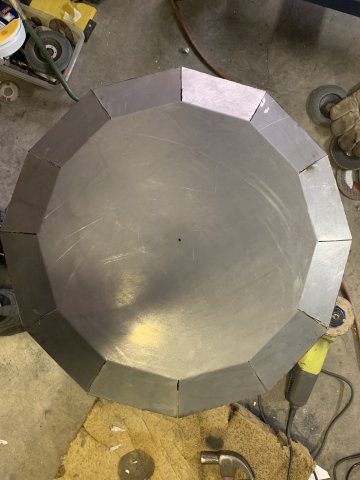

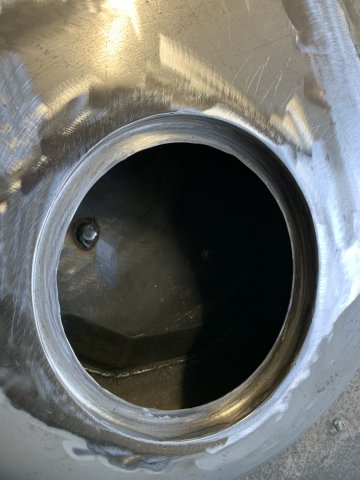

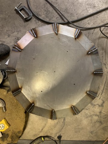

Core of the tank is now complete and can now to move onto all the ancillary pipes and fittings

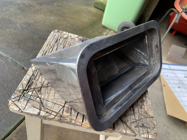

I’m having an alloy surge tank fabricated to sit inside one of the storage bins then route fuel and vapor lines between the 2 within an enclosed alloy conduit
An alloy bolt down lid will be made for the main tank where I’ve provisioned the access hatch and on which the pump filter etc will hang off for the main tank
I still have to weld in a filler neck and breather to the main tank to the vapor tank also
Then finally a round alloy plate will go over the top of the tank to seal it off from the interior and meet certification requirements

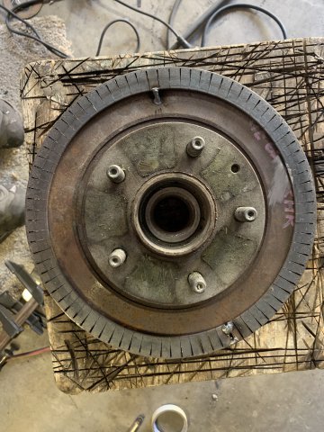

1 hour ago, 1969honda said:
Love the use of a hub and old brake rotor. Very keen to see the finished tank, looks very unique and functional; also sounds like a great use of the storage bin space!
Thanks Buddy
We are all a bit insane to have started these projects so no holds on how we accomplish the result I say ;)
