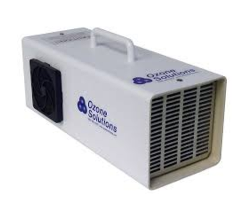

    Getting rid of that rat smell
    Still got the smell? I bet you do. I went down this road doing most of the stuff that all the other folks that responded did and still got rat smell. All the removal, cleaning, etc. IS needed but it absolute must be capped off with this little secret. Read about in another car forum and it absolutely and completely works. Search google for ozone generator rental. Works like this: 1. Rent the generator. They mail it to you. 2. Put it in the car (anywhere in the interior, I put mine in the hatch area. 3. Plug that sucker in the wall 4. Close up the car OUTSIDE your house, NOT in the garage 5. Let that fucker run uninterrupted for 24 hours (at minimum 18) 6. Unplug it and leave it in the car for an hour or so 7. Carefully and quickly open the car (doors, hatch) and move away 8. Let the car sit for at least 6 hours open. 9. Pack up and mail the rented ozone generator back to the company. 10. Problem solved. Rental for several days is about $200.00 Search for and read up about ozone generators. They break down the cellular structure of organic material and destroy odors at the molecular level. It does not mask odors - it destroys the chemistry that makes it smell. Its the same technique that hotels use when someone smokes in the room and they have to clean it. Did it to my rat farm 71 after blowing out all the rats nest stuff, scrubbing the bare metal, removing the dash and all vents and replaced the foam seats and seat covers. Only after I used this did the smell go away. 6 - 8 months later the car still smells like a new car smell.
