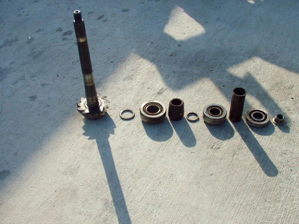

Order of assembly R200 long nose differential
zgeezer
This shows the long nose r200 pinion gear to the left. The order of assembly on the gear proceeds to the right. Note the two washers: they may not be interchangeable. On my assembly their positions were swapped and the clearances between the pinion and ring gear were so tight the pinion could not be moved without an eight inch wrench on the pinion flange nut.
That is a loooong pinion gear.
