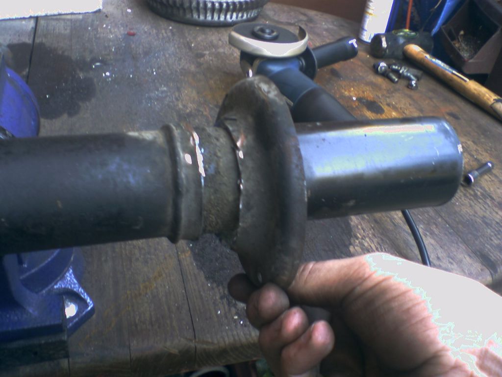

Coil overs step 5
thehelix112
Using a thin cutting disc on an angle grinder, cut the stock lower spring perch off. Do not cut into the strut body, I cut 6mm (1/4") above the weld to get enough distance.
280Z Coil overs
