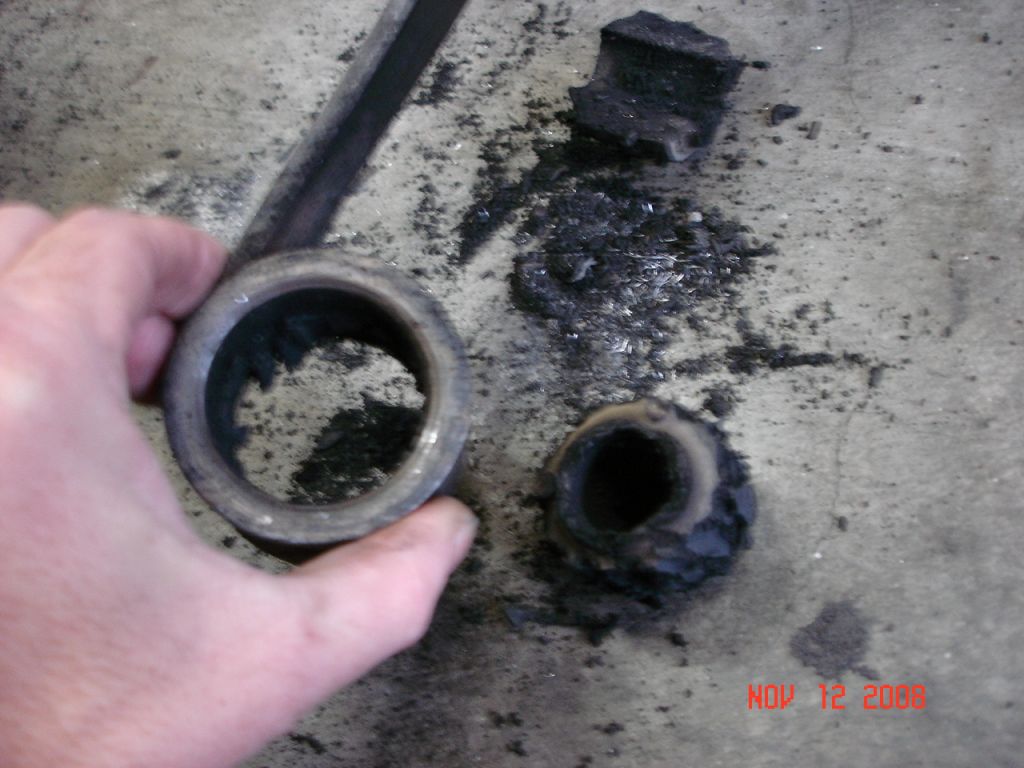

almost ready for ES urethane
HLS30-08077
After the pic, I used a dremel with the sanding drum to clean out the other rubber. Then cleaned it, Metal Prepped it and POR15'd it.
