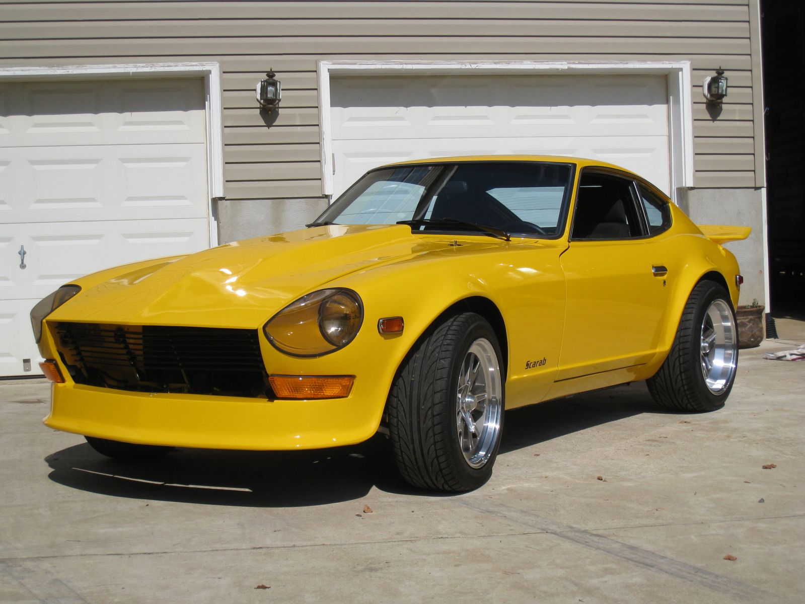

73 Datsun 240 Scarab. Family owned since new. completed a 5 year ground up (Total) restoration of the car in 2010, just prior to the Nashville z car National meet.
Car has a new 350 LT-1 (010) performance block built mildly w/ rare cross ram intake and two Holly 600"s. car has ALL the original Scarab equipment. I upgraded the supspension and brakes to Willwood racing set up from Dave @ Arizonia z Car. Wheels are custom made to car from Vintage wheels. Rear is R200 with all new heavy guts to handle the V-8. Trans is the original Borg Warner super T-10. Dyno was just over 500 ponies !! Color is 2002 Viper Yellow. under carriage is semi gloss Black and all suspension is Powder coated in gloss black. Body was modified and all hand done glass work.
