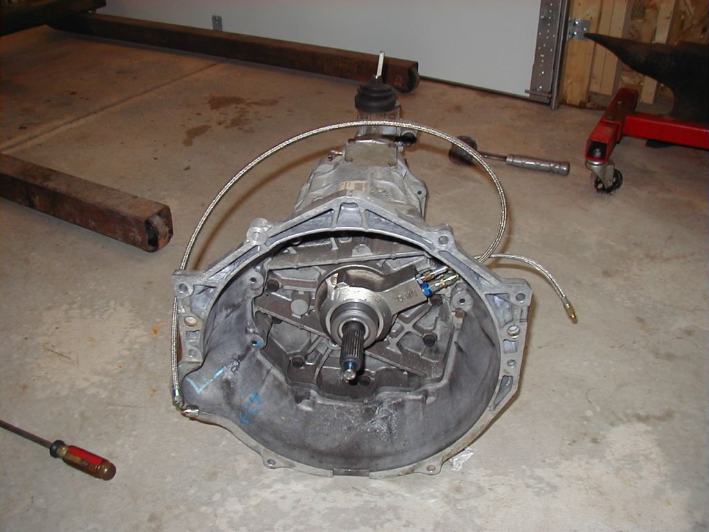

Quarter Master TO Bearing
240Z-DET
The bearing has a machined aluminum spacer for proper clearance. The pedal should be very light. The other line attached to the TO bearing is the external bleeder line.
