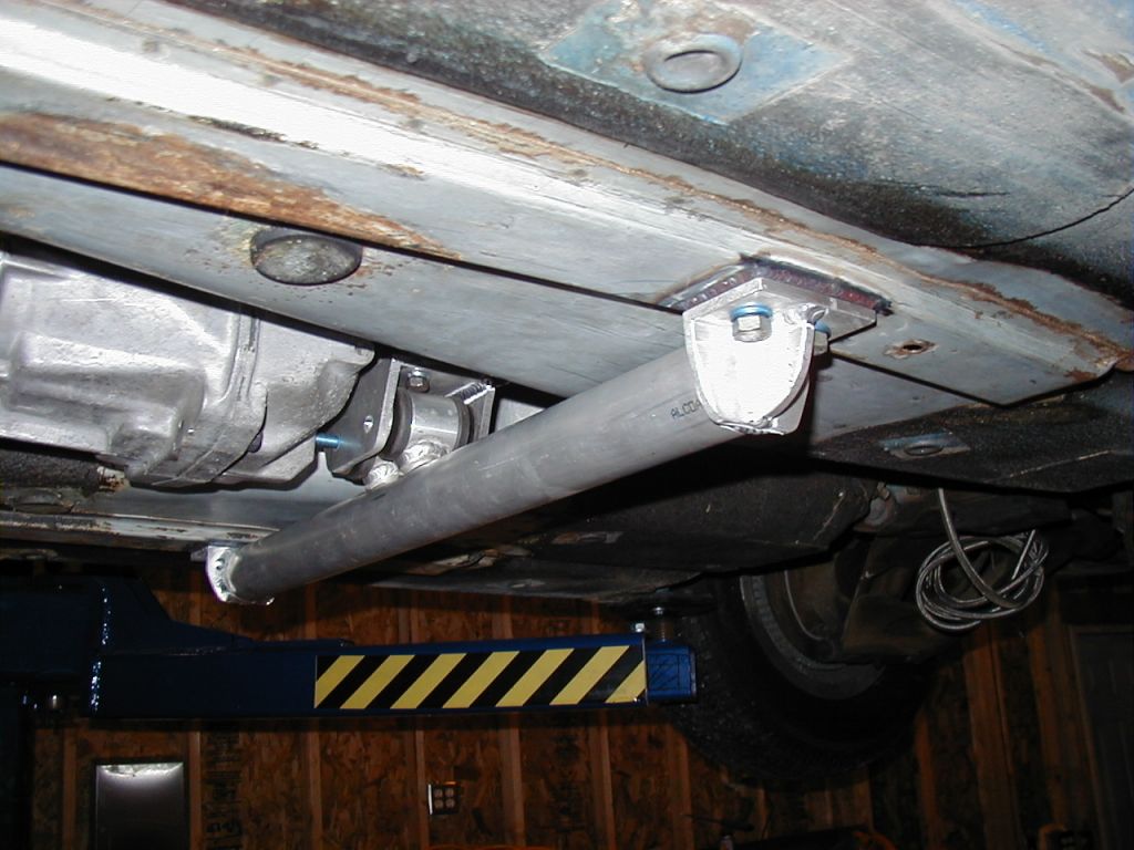

Right above each mount, a steel plate was tig welded to the frame rails for reinforcement. On the interior floor, steel plates were welded into the floor for even more reinforcement. Two urethane bushings in an aluminum collar mount the trans to the brace.
