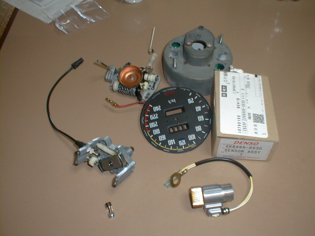

AIM speed sensor
KAZU
I extracted the internal of speedmeter. AIM speed sensor is put on the internal frame. it senses lotating magnet. Right front is DENSO speed sensor. It is direct bolt-on S30 to Z31 5-speed. some electrical knowledge and a couple of resistors are needed to work with AIM logger. It can be connected with Autometer.
