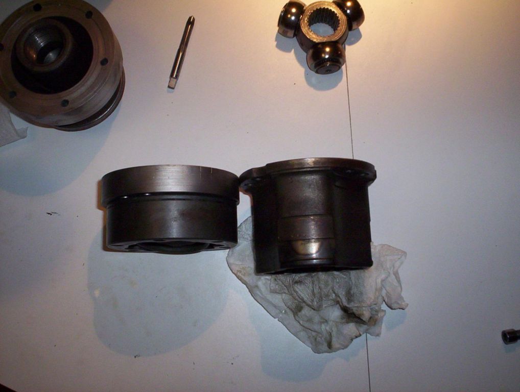

Compare the difference in thickness of the porcshe cv and adapter to the 280ZX. The boot is nearly .75" closer to the flange which should ease the sway bar clearance issue.
