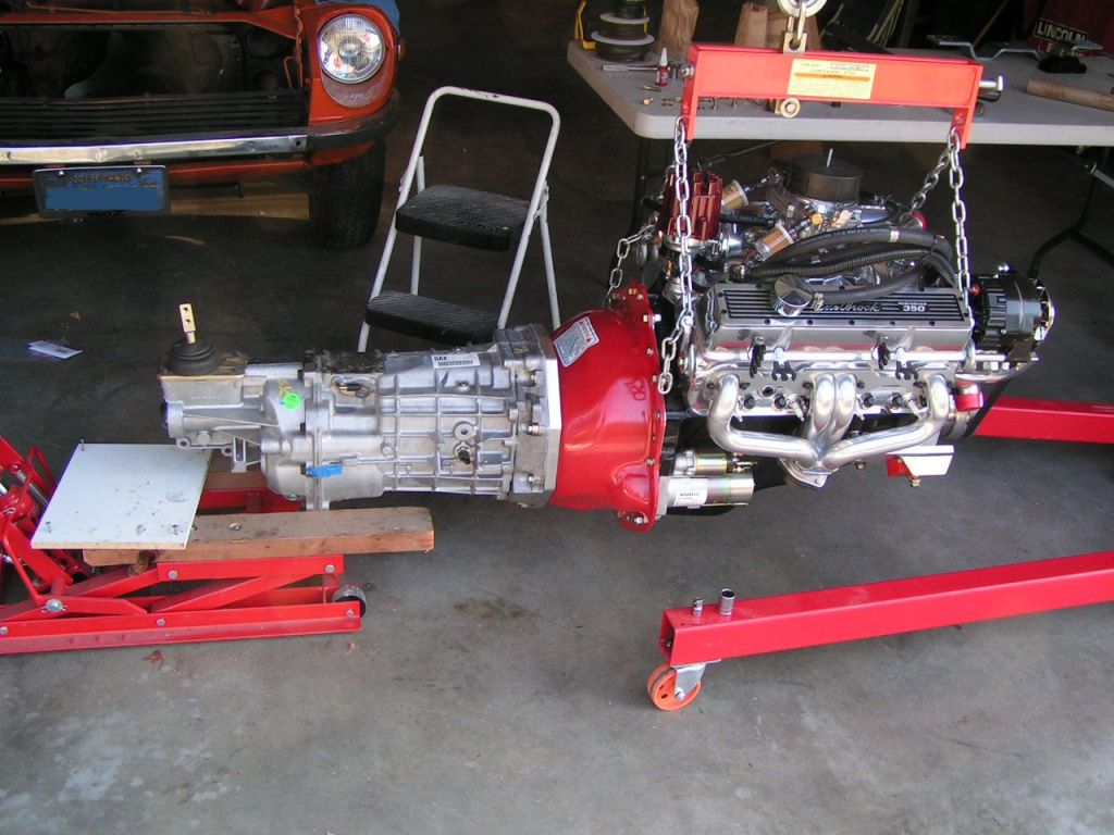

LS1t56 and Gen I 350 (pre 86)
BrandonsZ
There is a transfer plate between the tranny and the bellhousing and a special custom made pilot bearing housing that presses into the stock crank opening. Otherwise it is a standard bellhousing for older 350's and a standard clutch and flywheel.
