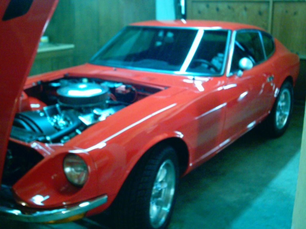

3 years and $21,000.00 later. Subframed rust free California 73 240 with 427 horse 4 bolt 355 Chevy, new steel crank, pink rods, Keith Black pistons, Eldebrock RPM heads, Comp cam, roller 1.5 ratio rockers, Tremec, Centerforce II clutch, R-200 3:36 with Quaiffe and ZX C/V alxes. 6 point roll bar, trans crossmember is bolted to frame rails, not the floorpan, Wilwood forged billet 4 piston Superlites, 12.19 curved vane rotors, Sandersons, 280 master cylinder, Panasports, shaved, nut and bolt restoration with as many new factory parts as possible. All new bearings, seals, body gaskets, interior, windshield, etc. Energy supsension bushings, AZC springs, aluminized exhaust, MMS rear disc conversion, Tokicos, Corvette bellhousing, 3" aluminum driveshaft with vibration dampner, 280 vented hood AZC billet moustache bar, Camaro radiator, S/T sway bars, 80/100 watt Hellas. Mercedes Tornado Red, urethane with clear coat. Honda CRX SI seats.
