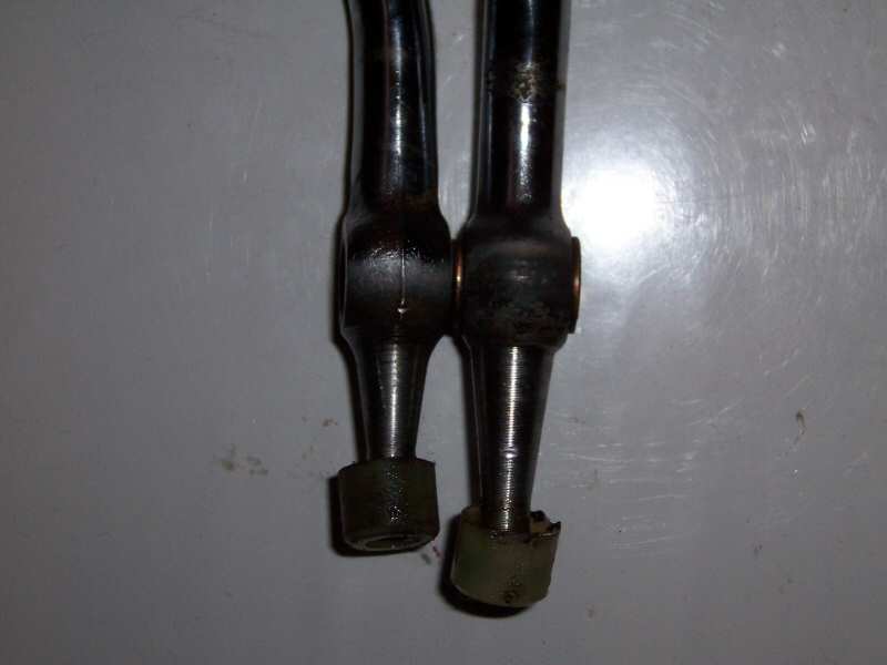

5 spd left, truck shifter right-- courtesy tec280zx
Darrel
This is a pic from jmortensen. Notice the mark on the truck shifter just above the cup. This is where it hits the top of the shift rod cut out. I put a 4 spd shifter in a late 5 spd and I had the same mark.
