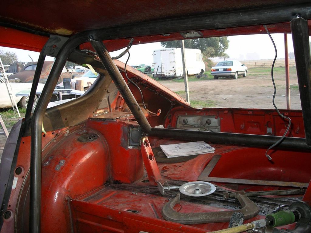

Cage Main Hoop
steve72z
The starting point of my cage, The hoop has been modified since this pic to be within the SCCA spec of 4 bends @ 180deg -10deg. This pic shows the main hoop at ~190deg.
