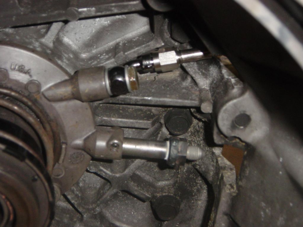

i used a banjo bolt and 'an' line to mount a clutch bleeder line that will be easy to access. the lower is the clutch slave line that goes to the master-originally a quick discon [gm oem] now a welded on '-3' fitting.
