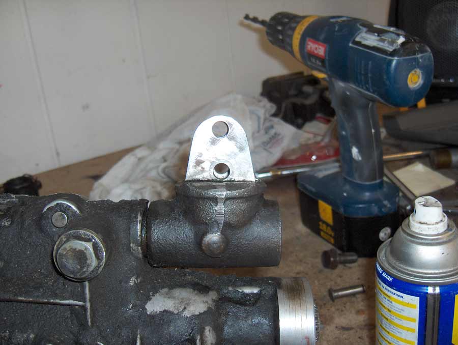

late 5 spd new pivot for short throw shifter
drilled 1 1/16" higher. The 5 spd shifter will be cut, drilled, tapped and a stud installed to lengthen the bottom pivot point. pic courtesy of thunderz
