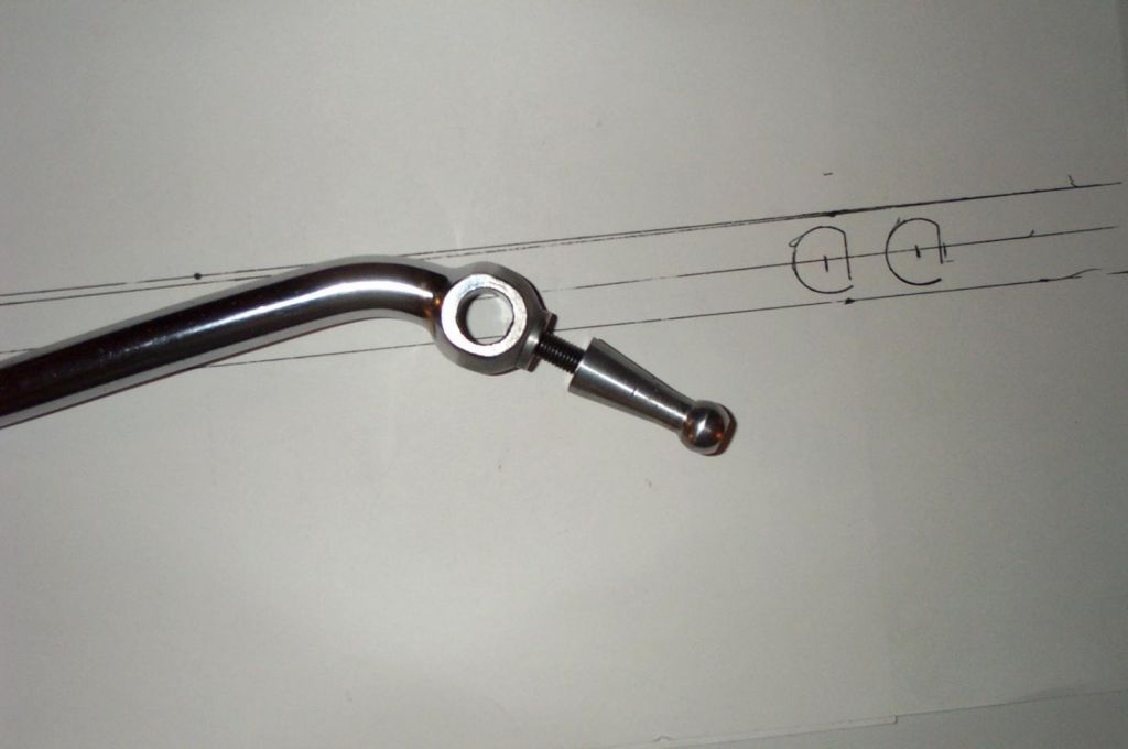

short throw mod
Darrel
cut, drilled and tapped 4 spd shifter. Will be using nuts and washers as spacers to strengthen the stud. This would be for use on a late 5 spd with the longer ears.
