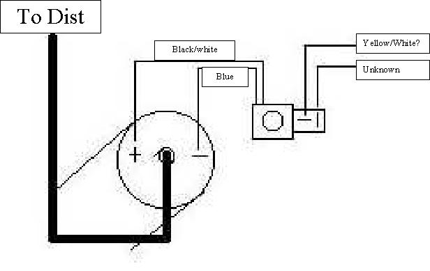

black/white is a direct short to unknown (your diagram) which is switched 12v. yellow white is correct which is computer output signal. The coil does not have 12 volts until the computer (yellow/white) signals.
