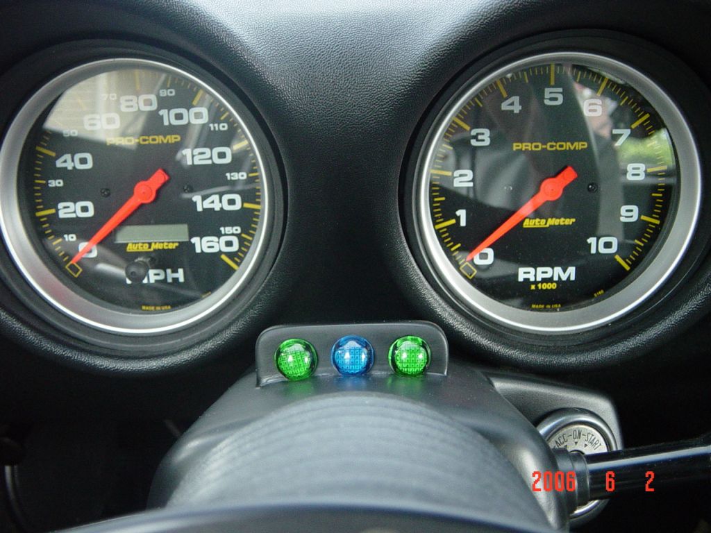

my turn signal & hi beam indicator pod-done
1 tuff z
this shows the pod we created to house the turn & hi beam indicators. i used incandescant vs. led's because i didn't want a bright light buggin' my eyes at night. it's epoxied to the upper clamshell and uses a molex 5 pin connector [i salvaged from my totalled 82 zx] so i can remove it without cutting wires. works great and looks subtle.
