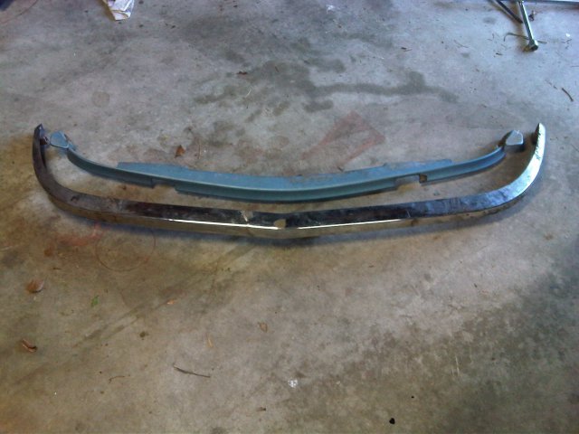

  15. I got a 73? bumper from a local guys junkyard for 30 bucks. I have welded up all the holes and I was starting to fit it to my 78 and I noticed that the old style was much 2 inches wider than my trim piece that went in the same bumper spot. I thought about putting that trim piece in for a bumper than I slapped myself out of it. Any suggestions for fitment? I might cut out 1 inch in two places and weld back together. lot o work though.
