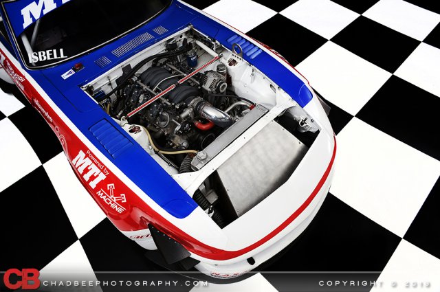

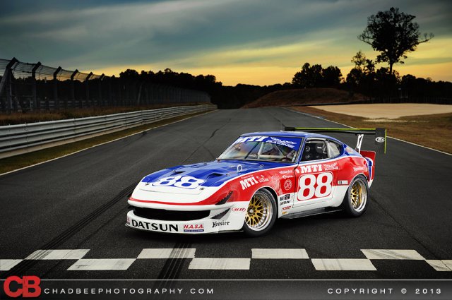

Some spy shots of the new MTI Racing GTZ racecar........(she's been out of comission for 16 months now) new carbon fiber wide body new MTI built LS7 427 race engine w/ more hp (650rwhp) new 102 throttle body and 102 LSX fast intake new V5 race cam new ARE drysump and Razor pump new tube frame front clip new upper and lower control arm Howe suspension new MTI Machine custom CNC hats and AP Racing brake caliper brackets new adjustable Bilstein coil overs new Howe spindles and hubs new side pipes and custom headers new PPG dogring T56 transmission We widened the cars track width 4" We lengthened the cars wheelbase by 4" New 2" wider CF rear flares we dropped the fuel cell by 10" relocated the ARE dry sump tank to passenger floorboard at firewall relocated the battery to passenger floorboard relocated cool suit cooler to passenger floorboard new radiator new GT style air box from grill to hood new heat exchanger new CF cowl hood new CF rear spoiler (same wing) we changed the degree of rake in the nose for better downforce aero new splitter/undertray redesigned the opening in the gnose to decrease the drag new window net (the old one had expired) installed seat bracket to recertify the FIA RACETECH seat GET READY................ -

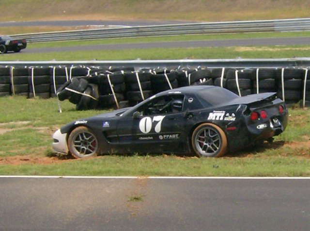

Keith, That trap has always been there. Remember that is looking back up the straight at T15 T16. That is the final track out pit. It doesn't do much if you are at full speed as I have gone through it and totalled my Corvette in the tire barrier at 130mph impact. My data shows where my speed actually increased when I went off......It had been raining for days and the track was green and the sand was very packed and not raked or furrowed. You mean that Sand Trap? -
