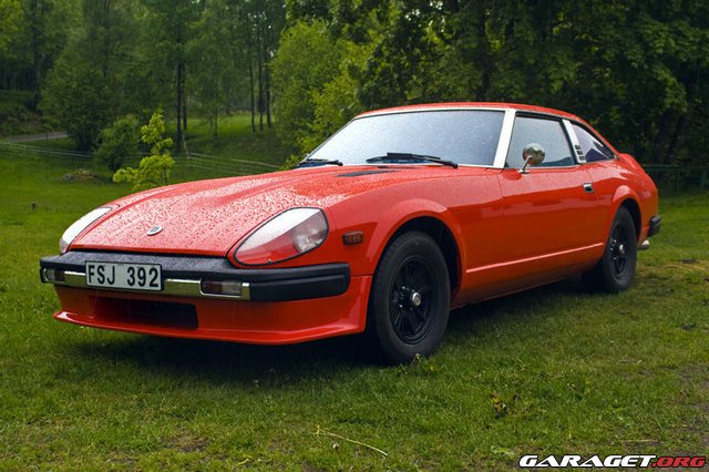

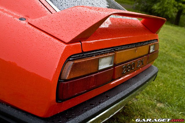

Hi.... Could need som help....again...hehe. Could you guys have a look on the pictures below and tell me where the hell my front airdamm and wing comes from. Would kinda like to have sideskirts to match it... Cheers.... /Swede
