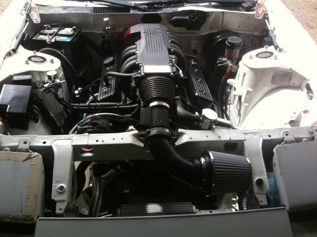

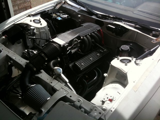

  4. Hey guys.....my z31 sbc project is throwing thru some loops and I'm wanting some insight. It's an 87-94 305 with an 86 tpi setup. Car runs well but blows more oil smoke than I've ever seen a car do. Bad enough I had it towed home from work. Just got the headers off and both cylinders 6 and 8 are just dripping with oil. All other cylinders are dry. 6 and 8 exhaust valves have 2 intake valves in-between them so I have a hard time Beleiving it to be a headgasket, cracked head, etc. Maybe a shared oil galley somewhere? Also have a hard time believing it could just be valve seals and guides on 2 side by side cylinders and not the others. ..... Gonna take some compression readings before starting the teardown to the heads..... Any ideas? Ty, tim
  5. I did not rebuild the motor before install.... Took a chance with a used tbi 305 out of a 87-94 k1500 that was readily available to get this project started. I tried to drive it home from work this morning and the smoke has gotten much worse. I've been a master tech for a long time and never seen this much smoke out the tailpipe of a car lol. I'm pretty sure I'll be needing a new motor, which is fine.....just not sure what route too take. The tpi setup is a 86 maf. My goal is to have a fun car to hotrod my whole 3 miles to work or the golf course, not win any drag races. Obviously I'd like to have as much power as I can get for the money I'm gonna spend if that makes sense. I'm gonna run a compression test tomorow on the other 7 cylinders..... Only checked cyl 8 due to time..... And was at @130. I should probably make at new post about this, explaining my setup, symptoms, etc. Huh? Getting car towed back from my shop to the house in the mourning..... Just too much smoke too drive
  6. Well crap.... Took first real test drive too work... Blowing some serious oil smoke unfortunately. Happy with how it drove, but noe what to do with the motor problem. Any suggestions? I definately wanna keep the tpi system

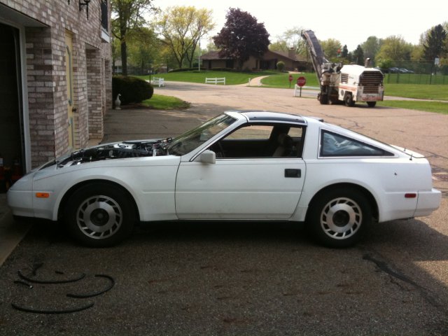

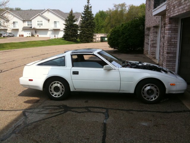

  8. Hi everyone, This is my first post here....thought id say hi and share a couple pics of my z31 I been working on for the last 8 months or so.
