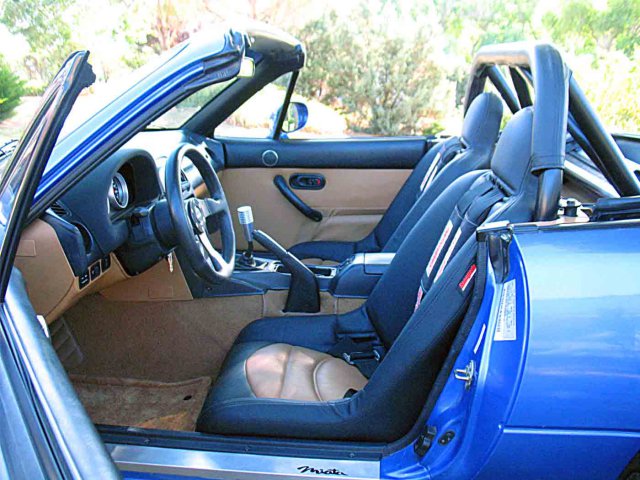

Thanks In the video, notice I didn't put the simpson belts on, I'm actually sitting on a folded beach-towel with the lap belts under me in new seats (never used before) they need to have my big butt sink in then I'm under the roll-bar plane (SCCA legal) -

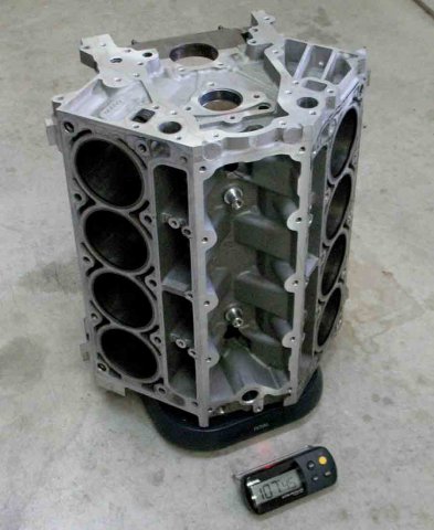

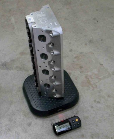

Here, this will stir it up! The block is a GM LS with 6 bolt billet steel caps on it. The head is a complete AFR. I'm chuckling because you can't get 2 GM engineers to agree on LSX engine weights and in what configurations, let alone 2 GM and 2 Ford engineers to ALL agree on what their perspective V8 products weigh. It's like politics, somebody's always lying, so the best thing to do is weigh them yourself. I have and I ain't talkin', if I did, next thing you know you'd wanta start arguing about big turbos. -

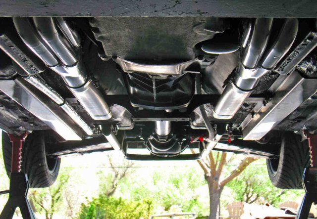

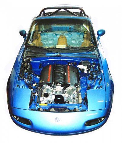

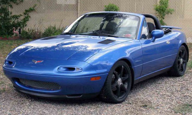

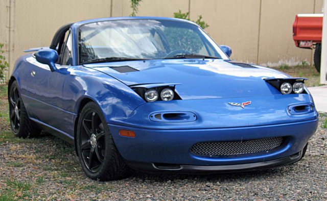

Thanks for your comments guys, I'll try to answer here; The drive-shaft's about 36", a Z-28 modded unit. The conversion is a one-off design / fab, there were No Kits when I started 3 years ago, however there are 2 great kits available today just expensive, as you guys probably can imagine from your own experiences. I always get the; "Why didn't you just Buy a Vette or Build a Cobra" comments, YOU guys all know the answer to that one. The conversion only adds about 118 total pounds to the front end, but is offset by the iron diff Ford 8.8 IRS and added tubular steel rear subframe reinforcement, Balance still very close to 50/50, Total Weight around 2700 Lbs. I have 3 friends with Ford 5.0 Monster Miatas that I have ridden in street and on track days, I DID steal the idea, except I'm a Chevy Die-hard and like the idea of "starting" with 400 HP Stock. I think it's a Modern Day; "Sunbeam Tiger":biggrin: -

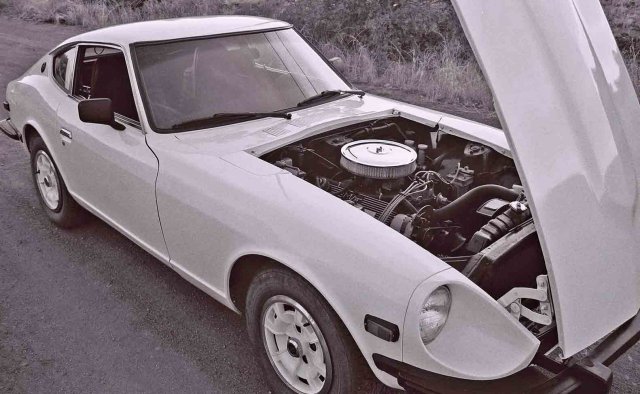

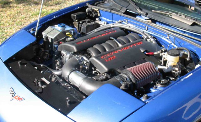

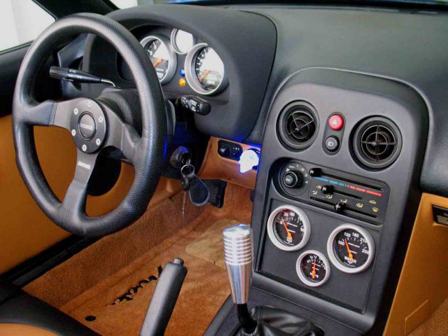

Beautiful cars Guys!! I guess outta pity because I'm an old guy and the fact that I've owned 3 "Z"s including a Ford 289 V8 73 240Z I built, Davy welcomed me and my little Mongrel Miata to the Forum. I'm drooling over all the great "Z"s you guys have built, I guess I'll just have to be satisfied though with my little Mazda. As you can see I started out with a used LS1 and later bumped up to a new crate LS2:biggrin: OOpps, forgot to list my specs; Total project time 3 years, just finishing No Kit, one off design / fab. Hella quad headlights, stailess mesh grill Ron Davis, cross-flow radiator, dual Spal 1850 CFM fans, custom remote fill tank. F-body accessories, GTO alternator, custom billet front engine mounts (solid) Crate motor, 2006 Corvette LS2, solid engine mounts (block to K-member) Fly-by-wire T/B 2005 GTO PCM, custom Corvette program, Corvette pedal Custom built headers, relocated steering rack (power, GM to Mazda) 7/8 sway bar. Thermal sheilding, wiring & brake lines 2002 Tremec T-56, heavy duty (ZO6, Viper) no skip shift, also solid mounted, with custom shifter Ureathane bushings throughout, KYB AGX shocks, ground control coil-overs. MOMO Wheel, custom built Renegade seats, simpson belts, Auto-meter sport-comp II guages. Hard-dog roll-bar, leather padding. Walbro 255 pump, all braided stainless fuel line, heat sheilded custom Z-28 drive shaft & u-joints 750 HP capable. Ford 8.8 SVT IRS 3:73 gears, Detroit True-trac posi. custom built 300M axles, Mark Williams hubs, ARP ZO6 wheel studs. Konig wheels, Toyo T1S 225/40 ZR-16 11" power discs, front & rear, EBC green stuff pads. 5/8" rear sway bar Dual 3" super 44 Flowmasters, with 3-1/2" dual stainless tips Entire interior was coated with 3 coats primer, 4 coats of thermal acoustic paint, under body with 4 coats also, including trunk area. Thanks for your interest guys -

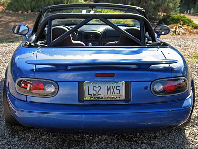

Finally, it's been 3-1/2 years since I started my project and it runs great and I went for a short run down the highway! I said I was going to finish the car completely before even statrting it, however boredom & frustration got the better of me. So, no 4 wheel alignment (just tape measurements on the floor), no skid-plate and open headers, I jump out on the 4-lane highway near the house. The solid feel of the entire car, the freaky smoothness of the clutch and transmission and the tremendous, linear acceleration are ALL GREAT, reminds me of a Suzuki GSXR 1100, but with more integrity than any of the Cobra's I've built or been in and with power windows and a real, convertible top!! Anyway been a long while since I've posted in here, though I tell you guys, and Thanks Davy for always making me feel welcome in here!!
