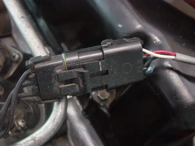

It doesn't matter at all. It has been running in this configuration fora long time. A couple of the wires got damaged and I want to source a replacement.
I found out that the injector harness on this car is actually from an SDS system. Mystery solved. Now to see if I can order a new one. Thanks!
Here is a picture of the connector if that helps.
Well I finally got a chance to get back into the garage this morning after delays for a track weekend and some minor surgery earlier in the week. On your advise, I starting checking on the wiring. I cleaned up a couple of grounds. Found and replaced 1 bad connector. When I was tracing the fuel injector wiring I discovered that the harness had fallen onto the rear of the exhaust manifold. Several of the wires had their coating melted. One was actually stuck to the manifold and possibly grounded to it. Looks like I need to replace the harnesses. Unfortunately, there is no part number on it. One of the connectors at the harness end had "P.E.D. 25" embossed on it. Any body recognize that?
