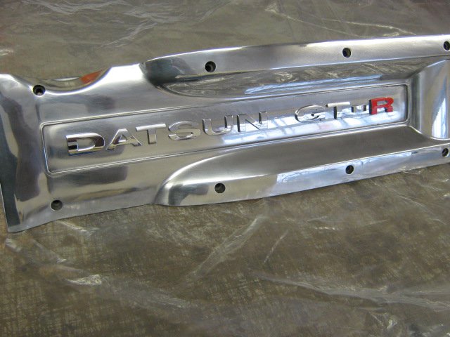

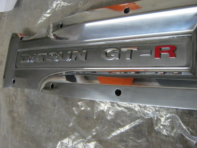

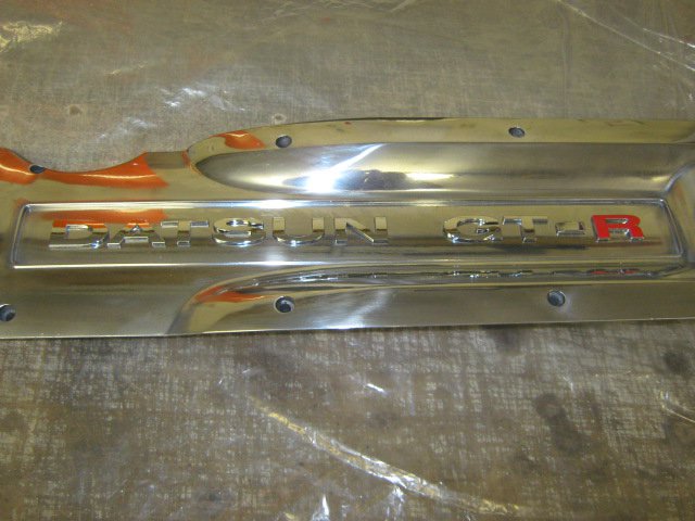

  9. Hi Mike yes place some red vinyl onto the face of the chrome letter in keeping with the original GT-R logo, no additional glue was used i have also done a set on Andy Shaws white 240z RB26 conversion over here and he has been running it for 8 months with no problems. Total cost was under $20.00 USD and 1/2 hours work If you guys want me to do some pictures and a explanation of how to lay them down and face cover a letter let me know and i will post it up.
  10. Yes they are the plastic chrome letters that i bought, the R was face covered in red vinyl, i own a sign company and did look at lazer cutting out some stainless and bonding them on but the chrome letters are a great product.
  11. Here you go Mike i did not like the original RB Coil Cover plate so i made my own up.

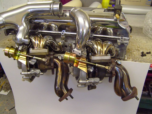

  12. Block still at engine shop some pictures of the top end and the sump mods.
