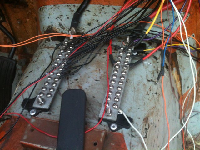

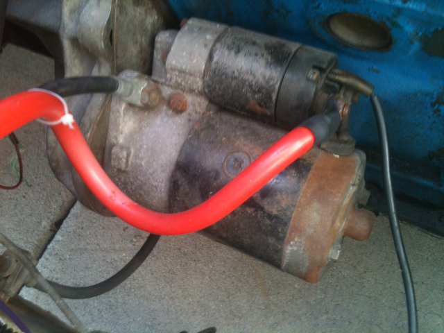

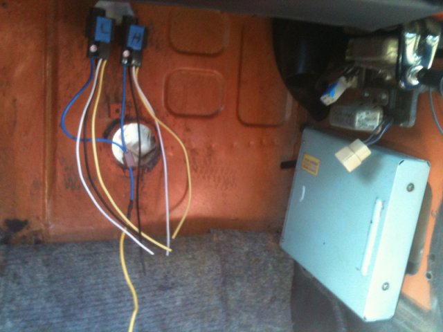

  2. This morning I connected the B/Y wire directly to the + terminal on the battery and got the same result, a single *click* and that's it. I believe that my issue is simply a dead battery. I also noticed that the ground I have connecting the (-) board to the firewall is weak, given that I connected the board to a bracket on the firewall. I am going to buy a new Odyssey battery from Porterfield and connect the ground directly to the firewall and hopefully that will solve my issue. Thank you guys for your feedback. I'm assuming that the starter solenoid isn't receiving enough voltage (e.g. dead battery) to pull the lever all the way, therefore this should be a simple fix. You will hear from me, success or not.

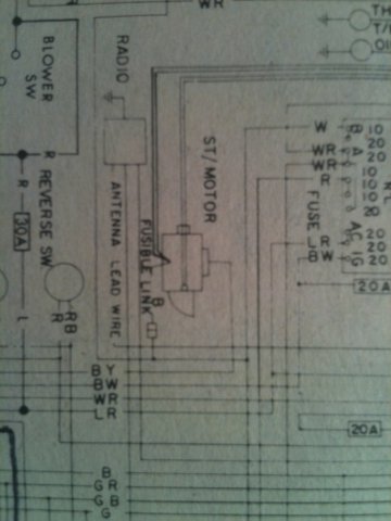

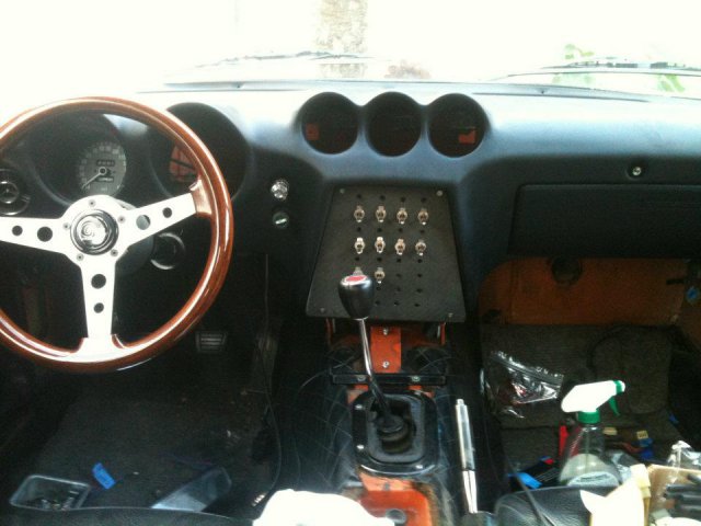

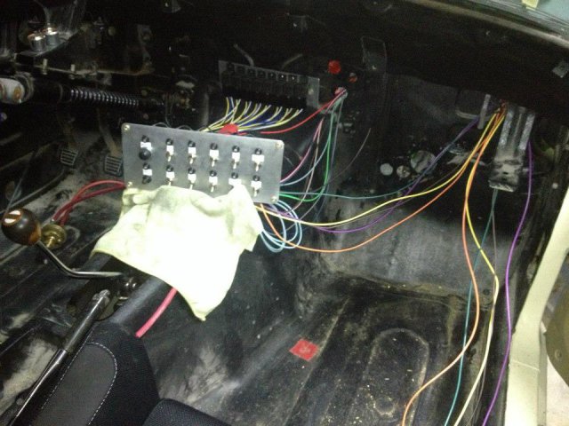

  5. After completing the re-wiring of my 240z, the last thing that is holding me back is my starter motor. I have the positive and negative 0 gauge wires that connect from the starter motor to the battery in the right place and have the B/Y wire connected to a switched 12v (this is my toggle switch that replaced the original ignition switch). With this current setup, I was able to crank the motor over a few times, but only once. Since then, whenever I give power to the B/Y wire, all I get is a *click* before loosing all power to the board. Given my current situation, here is my question. Where does the B wire that is connected to the starter in the factory service manual need to go? Here is my starter as it sits right now with only 3 wires connected to it. Here is the board I was referring to. The board receives power from the battery and from here all accessories are powered (each with a individual circuit breaker).Please excuse/disregard the huge rat's nest of wiring, as I will clean everything up once I get the car running. Lastly a diagram of the wiring for a 1973 240z. The B wiring I am asking about is the one that is attached to a fusible link which then connects to the + wire from the battery. I know that asking for electrical help in a forum is a longshot, but I figured I'd ask about that B wire (given it is the only thing I am missing) before spending a few hours going over everything again. Any suggestions are appreciated!

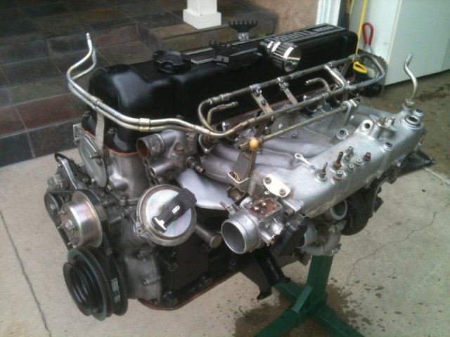

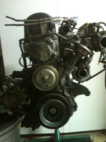

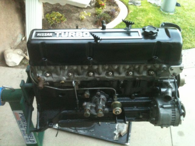

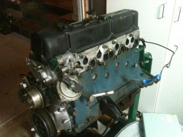

  7. Running out of time with still so much to do! Here is how the engine is currently looking now that it is reassembled. I still need a couple of various rubber tubes, as well as a fuel pressure gauge for my stock fuel rail as well as a fuel pressure regulator. Will update with photos of the modified stock rail once it is completed.

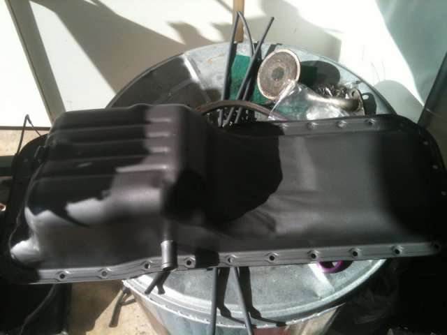

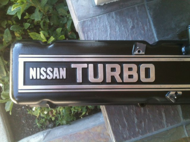

  12. Finished sanding the valve cover and painting the block. I think it looks great. You can never have too much black, right? Anyway, following the painting I reattached the motor mounts and the alternator. Loosely sat the valve cover on top just to get an idea of how it would look. Now just waiting anxiously for my gaskets... First off, this was how the block looked before painting: Valve cover after being sanded down, primered, painted and sanded with 100, 400 and 600 grit sand paper to polish lettering and border: Lastly, the finished product. Once I get those gaskets and I put everything back together and start getting ready to swap it in. Now back to sourcing a fuel pump, fuel pressure gauge and adjustable regulator, AFM, wiring harness, et cetera, et cetera, et cetera.... Bye bye Christmas money

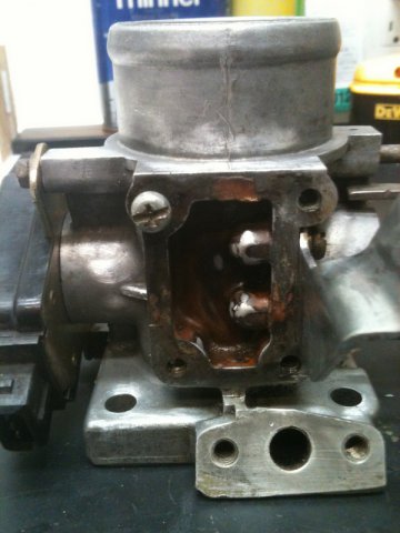

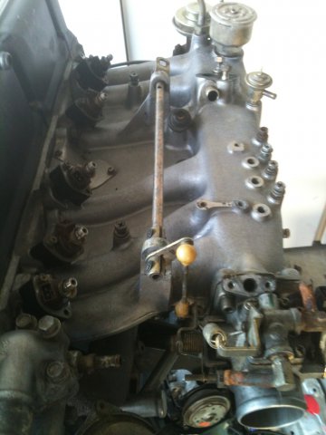

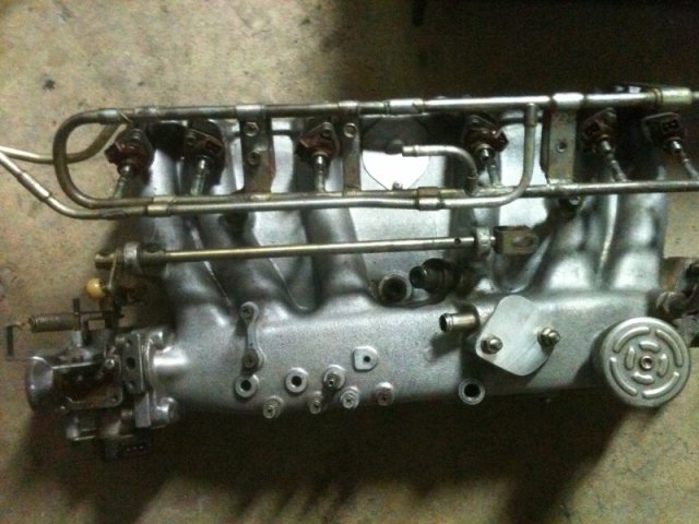

  13. Alright, so as promised here are some quick photos. Here is the stock TB after removing the coolant accessories. The pocket and lines were filled with rust, causing me to worry about what the rest of the cooling system of the engine looks like. I intend to create a block off plate out of aluminum to fill that ugly void. Next is my EGR manifold with a lot of the junk removed. In the process of plugging some of those wholes and making another block off plate for where the EGR canister previously was at the back of the intake. I am leaving a few of the stock accessories, including a valve which releases pressure during shifting and a back-up valve that will open if boost exceeds ~9 PSI. The reason for keeping these items are because of the fact that I am running a stock engine without a BOV. I felt that with the small stock turbo, the lack of a BOV would reduce the turbo spooling lag in between shifts. Now on to the timing situation. Here is what I believe to be TDC on cylinder one. The main reason for my confusion earlier was the Haynes jargon, but after some observation I believe I figured it out. I have the #1 timing position on the cam gear in the center of the shiny chain link. The #1 dowel hole is aligned with the "cam thrust plate" timing notch. Am I at TDC on the first cylinder now? Here is what the cam gear looks like, just another perspective of the alignment of the timing notches. Once again, if you are familiar with setting up timing, please let me know if this appears to be TDC to you. Cam lobes in the rabbit ear position. After a visual inspection and viewing into the side of the cylinder head I believe that both valves are sealed. Today I primered and painted my valve cover and motor mounts. I also baked my exhaust manifold and intake heat shield: 30 minutes at 200 degrees, 30 minutes at 400 degrees and 45 minutes at 500 degrees. All in all I think they came out nice, but time will tell if the good looks will hold up. If I my timing is all in order, I will move on to removing the cylinder head and oil pan before cleaning and painting the block. Once the block is painted, reconstruction will begin using a full gasket set from Northern Auto. More updates will come, but in the meantime it is time to clean up and get ready for the evenings festivities. Happy New Years Hybridz Members! -Wangan Zeto

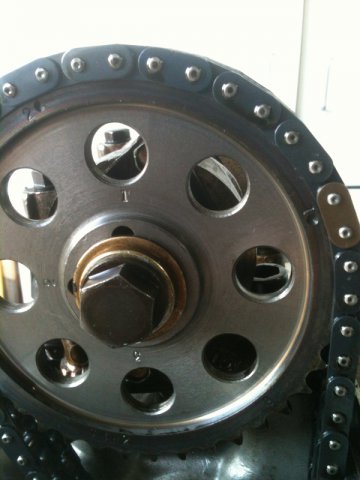

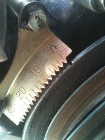

  16. Hey Hybridz Members, Was in the process of writing a formal write-up of my progress so far, but unfortunately I hit the back button and erased all my progress. Therefore this edition will be straight to the point. Here is an introduction and update of my project so far, a 1973 s30z in the process of receiving an L28ET. I had a lot of difficulty with uploading photos off of photobucket (hence me erasing my last draft) and decided to simply upload them under the attachments section. I will give you a description of the photo along with a corresponding attachment. I find this to be the simplest way to explain my goals. First off, here is my 240z as it sits in my driveway today. All I've really done to the exterior was add the ZG flares and clean up the rubber on the outside using acetone to remove primer. This is my 240z shortly after purchasing it for $3,000 from a gentleman by the name of Jesus in Compton, CA. It came with 16x8 XXR wheels, a harness (attached to the back of the seat with a screw ) and various other stock parts. Shortly after I went to my friend Keith's and began maintenance on the vehilce, along with rolling the rear fenders and installing ZG fender flares (also came with the purchase). A photo from the interior of Keith's shop. If you couldn't tell from the G35 and the race preped 240sx s13, Keith is a speed fanatic. He is has received his SCCA certification and is in the process of becoming a professional driver under his label REVelation. Without him, my project would not be where it is today nor would it have the same standard of perfection and attention to detail that it receives now in it's restoration and modification. So what better way to thank him than to present some car porn of his sexy, sr20det powered race car... Another shot from the interior... If you would like more information on Keith's 240sx, please visit http://rev-elation.blogspot.com for an extensive write-up of his project. So over the past few months, a few things have changed. I managed to do a rear disk swap using 280zx rear disks and rotors. Although it was a bit difficult at times (I had to take the brackets I bought and have them machined at the last minute in order to fit the calipers properly), I think the end result speaks for itself. The clearance between the caliper and rotor is even and the pads fully cover the rotor. It is also noteworthy that with patience I managed to do all of this for roughly $280, which included front and rear SS brake lines, ATE super blue brake fluid and caliper/bracket machining. Here is a photo of the rear wheel, what a beaut! Now that I was a little more confident with my stopping ability, I decided it was time to start looking into boosting that 150 horsepower that came stock in the L24. However instead of using the L-series as a foundation, I decided to try something else after Keith decided to drop a NA 2JZ in my lap for free. For a short period I was set on building an NA monster. I intended to run the 2JZ with triple carbs, using the intake plenum from the stock NA intake and welding flanges onto it. The thought of an NA DOHC 3.0L with triple carbs kept me motivated and dreaming, however after calculating a rough cost for motor mount modifications, transmission and drivetrain, I came to the realization that it was simply beyond my budget. So the 2JZ received a good cleaning and sat. Then one day I came across this... I managed to purchase a L28ET from a 1982 280zx for $260 (I could've gotten it for $250, but I didn't have change and felt that the seller deserved it anyways for the favor he was doing). Shortly after getting it into my garage, I began removing the A/C condensor and power steering accessories. At the moment I am in the process of trying to refresh the motor making adjustments here and there. My goal is to shoot for around 250HP while remaining cost efficient and goal orientated. Therefore a lot of the stock parts are being cleaned and restored instead of being replaced by expensive, more flashy after market goodies. The intake manifold and stock fuel delivery system is not pretty, however I simply don't have the extra money to spend on a nice Pallnet fuel rail or a 280z intake. Therefore, I am cleaning the current piping and replacing all rubber. 3/8 rubber will be used for the feed line while 5/16 rubber will be used for the return. The stock fuel pressure regulator is being removed and a fuel pressure gauge will be put in the same location on the stock fuel rails. I will use an aftermarket fuel pressure regulator mounted on the firewall earlier in the feedline. I figured that while using the stock fuel injectors and ECU, this is my best option for fuel management. As far as the intake itself goes, I am filing down all the unneccesary brackets and smoothing them out. While I know that I can made block off plates using aluminum, I am still searching for a way to cover all of the other unused vacuum holes that currently exist. Any suggestions? Sorry for the sideways and excessively large photo, but these are the stock injectors after being removed and sprayed with intake/carb cleaner and some 409. All connections were cleaned as well. As mentioned above I will use these up until the time comes for NIStune when I will probably use a newer O-ring style of injector, possibly from a Toyota Supra or other easily available vehicle. As you can probably already assume, I am going the Z31 300zx ECU route for my engine management, considering it's effeciency, MAF sensor and compatibility with NIStune software (Keith recently purchased program rights to NIStune for his 240sx, therefore he can assist me in the tuning of my vehicle when the time comes ). So basically the build will go as follows: L28ET BUILD 1982 L28ET with stock internals Stock fuel rail with 3/8" feed and 5/16" return, 0-100 psi FP gauge and aftermarket FPR 260cc Fuel Injectors Stock intake manifold cleaned up with unnecessary accessories removed and ported to match 60mm 240sx throttle body Gasket overhaul set Stock exhaust manifold cleaned and treated with flat black high temperature paint Custom intake, intercooler and piping (no BOV so far) 300zx Z31 ECU and MAF Oil cooler and possibly relocating oil filter to remote plate mounted on side of engine bay. Rebuilt stock turbo (done by Keith and myself) 3" Exhaust & MSA downpipe If anyone has an suggestions about this build list, your advice would be greatly appreciated. As you can see I have focused on the ECU, intercooler, exhaust and fuel delivery as my main priorities. This is because my first goal is to simply get the engine up and running while running as effeciently as possible stock. Once I have that foundation, I will have the freedom to do more intensive modifications. If I am as lucky and patient as in the past, I should be able to have all this done in the near future and still remain, dare I say, under budject as long as I stick to my habits of constantly browsing craigslist and Ebay until an opportunity presents itself. A picture of the interior of my Z. Currently going through the process of re-wiring the entire harness. While tedious and challenging, it will be well worth the time and money in the long run. As you can see, or not dependent on how these pictures load, I have replaced the center console with a piece of dry carbon that will hold all of my toggle switches. These will control everything from ingnition to rear window defroster. Instead of using the stock fuse box, I decided to go with individual push-reset circuit breakers mounted above each toggle switch. Although the $200 investment seems steep, the Klixon circuit breakers I intend to use are very high quality and will make it much easy to isolate each component for future ease. Lastly, the picture that captivates the motivation for this build. What initially began as an obsession with the Devil Z from the Wangan Midnight series (I hate to admit it, but it's true), developed into a need to create something both unique and personalized. My goal is to create a fun daily driver with a lot of racing influence doing into it's design. While attention may come with such a unique vehicle, only a few can truly appreciate the blood, sweat and beers that have gone into it's creation. This project also symbolizes my transformation from a teenager who liked fast cars but whose mechanical skills peaked at an oil change to an inquisitive student of tuning performance vehicles. For those of you who have made it this far, I thank you for taking some time to read about myself and my project and hope that you got some joy out of sharing my experience with me. I would also like to thank the Hybridz community as a whole, considering that it is the Library of Alexandria when it comes to Z modifications and also is a good resource to use when you are feeling a lack of motivation (simply search Big Phil 280zturbo on YouTube and watch him spin his tires in the first 3 gears to get you back on track). With that being said, I hope to keep you updated. I just started winter break from my teaching credential, so I have a little over a month to work on my Z. I hope to have it at least up and running by the end of the break. With or without the L28ET installed depends on my commitment and my luck lurking through craigslist and junkyards.
