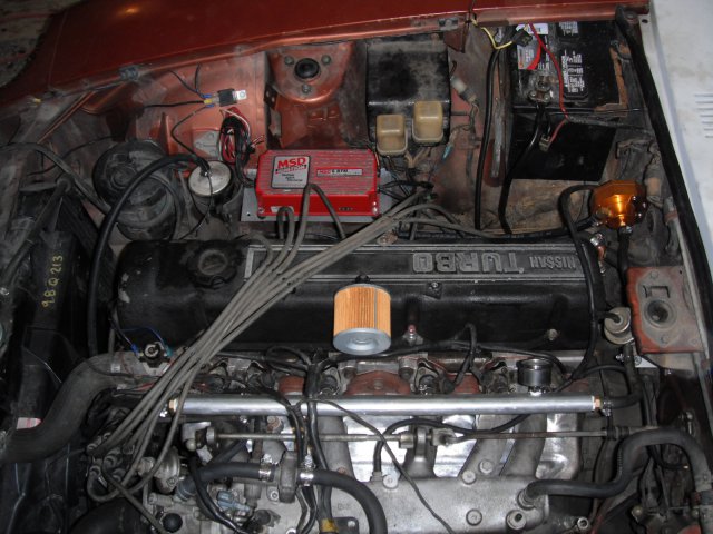

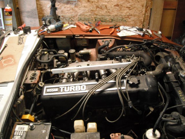

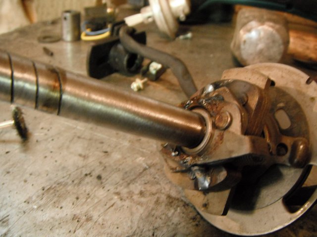

  10. Sorry to take so long with pics. Heres engine bay with 6btm mounted but not wired (waiting on tach adapt) My plan is to run stock n/a initial timing with locked dizzy and use btm to retard (slightly) on boost. Other side of engine.

  13. Does anyone recommend teflon thread tape as an extra measure (on the threads of course)? Any feed back on the AFM adjustment? Makes sense that it would run rich at idle with the bigger injectors (remember I have only started, idled, and revved to maybe 1000 at this point). I want to wait for the BOV before I test drive. Ignition advance: Being that I have already welded the mech advance AND purchased the BTM, what are your recommendations?
  14. Update! Installed AFM, Locked distributor, attached downpipe to old exhaust. Everything hooked up temporarily for start/idle test. I wanted to make sure car would run before I tackled msd retard ignition (also waiting on blow off valve). Starts and runs! Problems: Banjo bolt @ turbo leaks even when really tightened - should I order new, or is there a better fix? Idles very rich and rough - I push back hard on afm counterweight and she smooths out quite a bit. Is this going to be a drastic adjustment (lots of teeth on the gear) to lean it out?

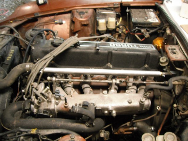

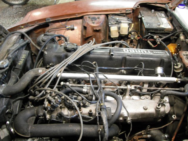

  15. Intake manifold, injectors, fuel rail, stock fpr, fmu installed. Starting to get crowded in there. What's the best (easiest, cheapest) way to do AFM to turbo? Can I supply both fpr and fmu with the same vac line from the manifold (tee), or should I run separate? Up next: locking dizzy, temporary attachment of downpipe to old exhaust, MSD retard, bov on j-pipe, bosch 044 fuel pump, fuel rail gauge, boost gauge,

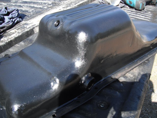

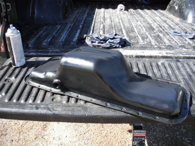

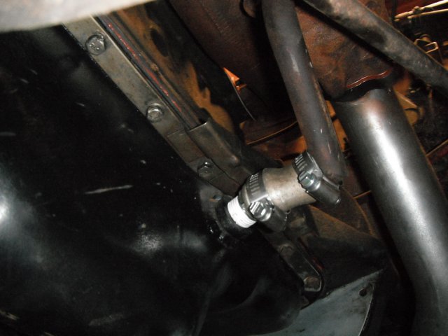

  17. Fuel delivery and engine management aside, here's the latest: Oil pan unglued from block (fun), cleaned, painted, new bunghole! Final (hopefully) mounting of turbo, manifold, downpipe, and oil lines.

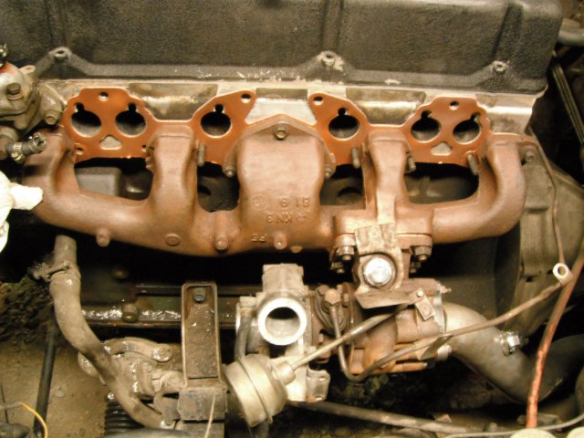

  18. The 6:1 is already paid for and here, so I will go that route and turn boost down (if I can). Take a look at the threaded actuator rod - is that factory? Do I shorten it to make the wastegate open sooner? I plan on the MSD box, and will sell it when I megasquirt (next summer). I just want to get it up and running in the next couple of weeks to goof around before the snow starts flying. I figure I can wire a boost retard quicker than a megasquirt. Here's the turbo and downpipe mocked up so I can mark the oil pan for the return (waiting on manifold gasket).

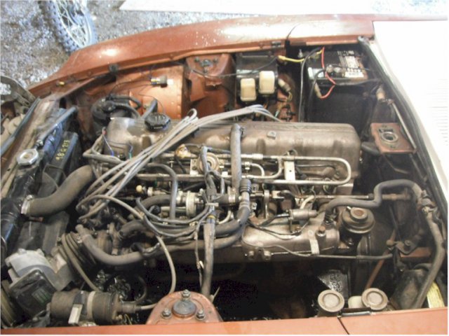

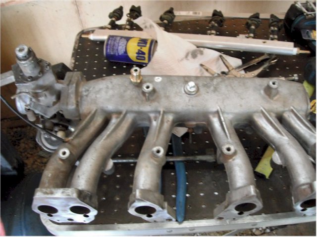

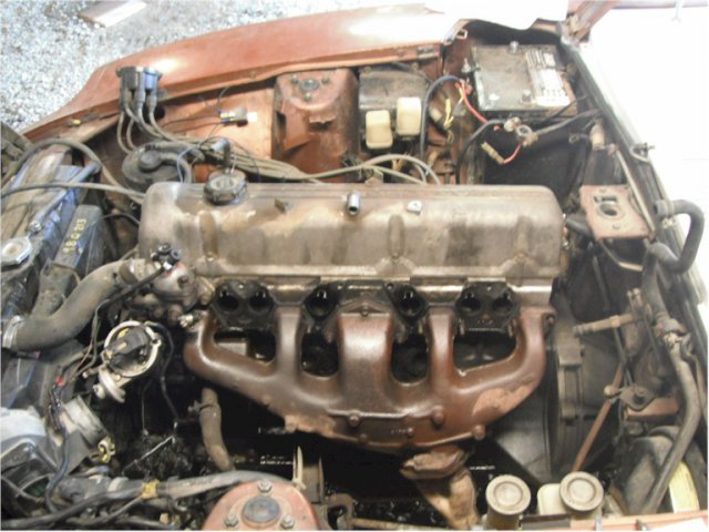

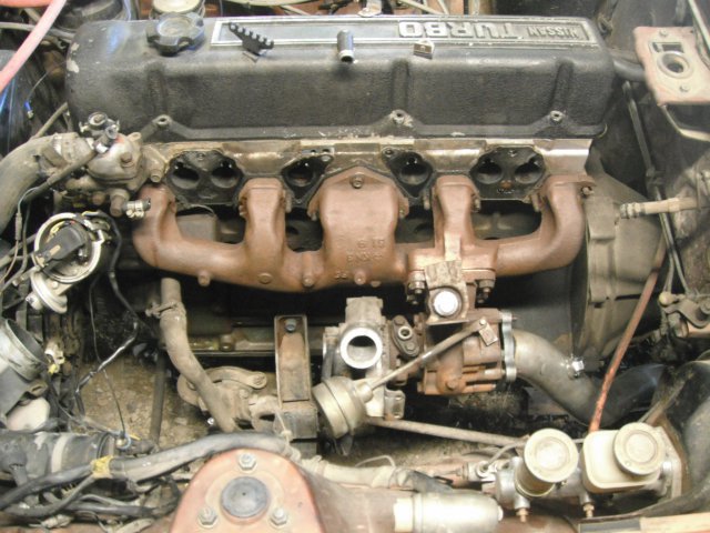

  19. Progress! Relocated pcv valve on new intake, removed old intake from car. Would have old exhaust off except for stud under water neck - feels like it will break. I will let it soak tonight and tomorrow and break it on Monday. Got some pics, too. Question: Can I delete the little coolant-fed hot plate under the AAC? Is the AAC powered open/close, or is it bimetal spring - end switch setup? My plan is too plumb it to the J-pipe like I've seen on someone else's build, but I'm not sure of the reason. Idle stability? Also, I've seen some turbo builds w/ non egr manifolds where the cold start injector has been deleted. Is this a good idea? I would like to be able to drive the car late spring to early fall, so there may be some cold morning starts. Thanks in advance.
