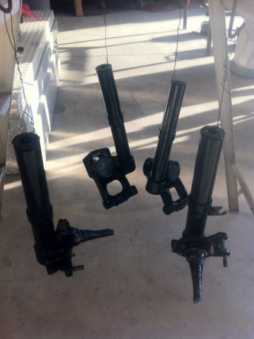

Thanks for the replies, it is for a 1975 280Z. I am sectioning the struts, but lost a pair of the nuts for the front struts. Will they still screw in when the strut is sectioned? If anyone knows someone with a parts car or a site that sells them I would really appreciate it. The struts I received did not come with strut caps. Thanks, Ramsey
