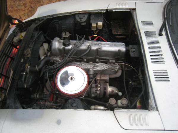

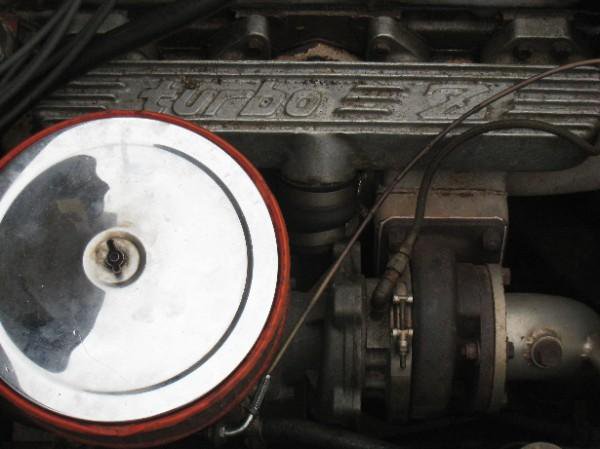

  5. Here are those pictures. Turbonetics Delta Mark II Waste Gate. E88 Head N42 Block and CWC Cam Took off the intake and exhaust man, and bad valve seals so far
  6. it was helpfull as thats where i identified the e88 head. today is for identifying parts so we know what were working with. turbo kit is odd as it has a rajay turbo unit with draw thru holley 4bbl and the intake says Turbo Z really big, its aluminum and the inlet faces down to the turbo. has cast exhaust mani. we want to get it to run like it should with the turbo, were sure the followers and cam need replaced but some cam metal has probably made its way somewhere as alot is missing to the point of some missing lobes. even with engine problems it was worth what he paid.
  7. guy i met today thru my dude adam ( dudes first import, were the mechanics) just bought a 1976 280z turbo. this turbo set up looks dead on factory but since there was no L28et in 76..... he bought it in great shape for alot less than i think just the body was worth. kid said he just put a new mani on and that it has a new valvecover gasket. well also said to have a timing and starter issues. it had timing issues alright. like listed in the thread a few down titled "cam damage" this one is so bad it has no lobe just where the followers were on all but one oddly. head looks redone with heavy duty springs and retainers, possibly manley by the looks. cam has CWC in it also... now since it obviously has been modified given it has a 5spd, turbo kit, and cam with spring kit. where do i look for codes and what codes mean what? cause i don't know if it still has a 2.8l in it because i think i seen e88 on the head.
